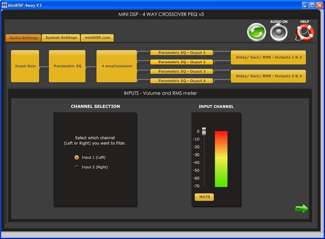

System input screen allows you to choose subwoofer type (mono or stereo) if you have the 2.1 plug-in, load, and save settings, and do a few other things which I haven’t used:

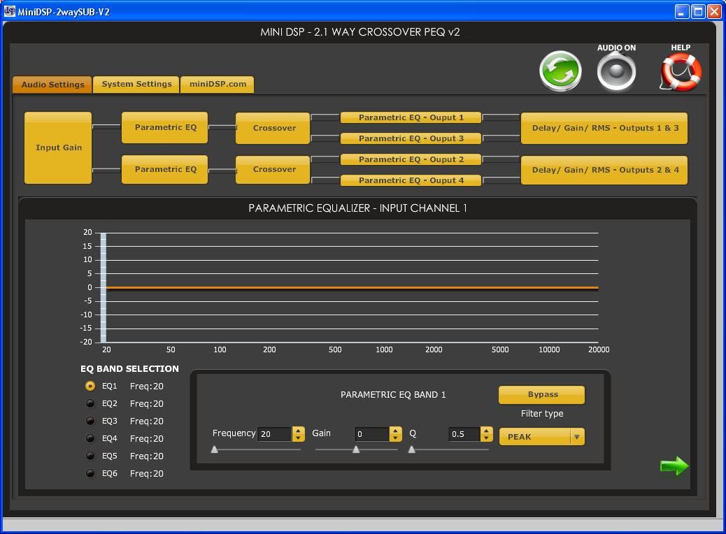

Here’s the input gain screen of the 4-way PEQ plug-in. Note that you can see how the mapping structure links the crossovers. This is different from how the 2.1 screen maps the inputs to the outputs (pictured below 4-way screenshot).
This screen also allows you see how the input signal is affecting the input stage, in case you're worried about the preout voltage of your headunit being too high. More talk on this below...

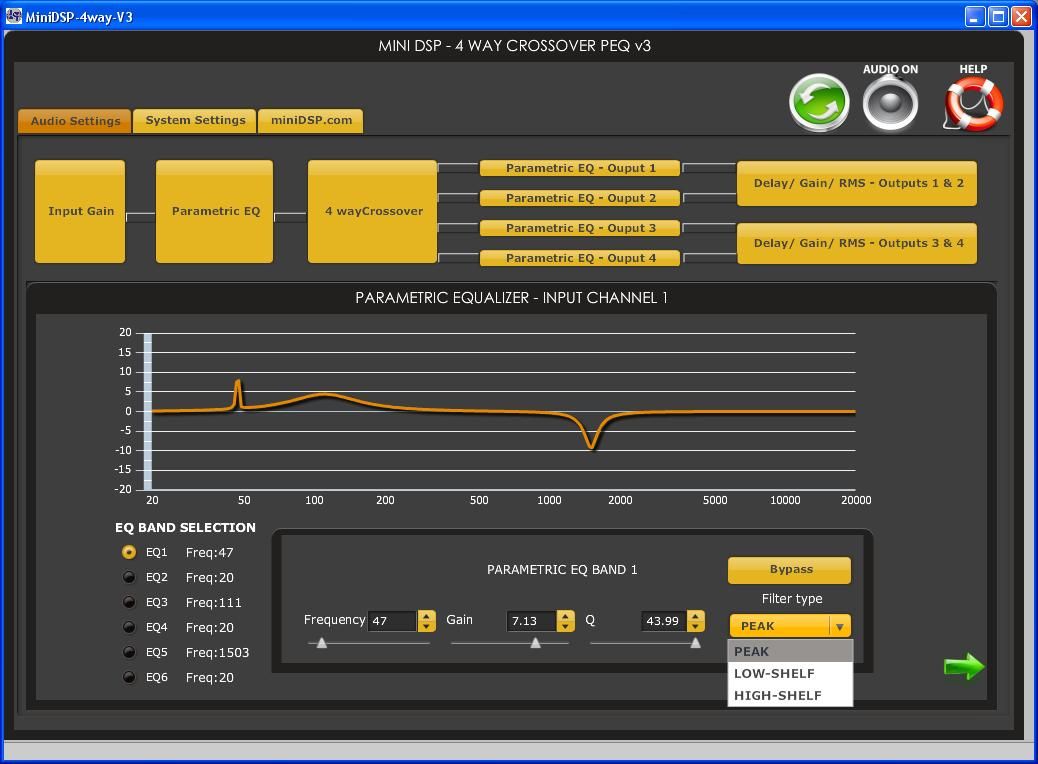

Screenshot of the Input Parametric Equalizer settings. Note that you have 6 bands of P-EQ for each input and output.
More importantly, note how you can set the ‘Q’ bandwidth anywhere from 0.5 to 50 and you have a ±16dB swing to adjust the EQ levels. Quite awesome. I know of NOTHING else in the car audio world that gives you this kind of control. And, yes, you can overlap EQ bands.

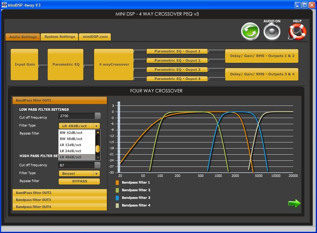

Screenshot of the Crossover for the 4-way PEQ version. Note the various types of crossovers and slopes.
The coolest part? You can TYPE in ANY crossover point you want. Check the picture to see how arbitrary crossover points can be used. Note that you can bypass the crossover with the push of a button.
Here’s one of the output PEQs. Same as the input PEQ:

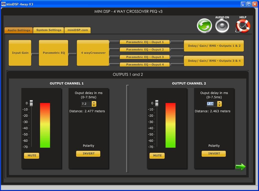

Output Levels screen, which also has the mute feature, time alignment and phase adjustment.

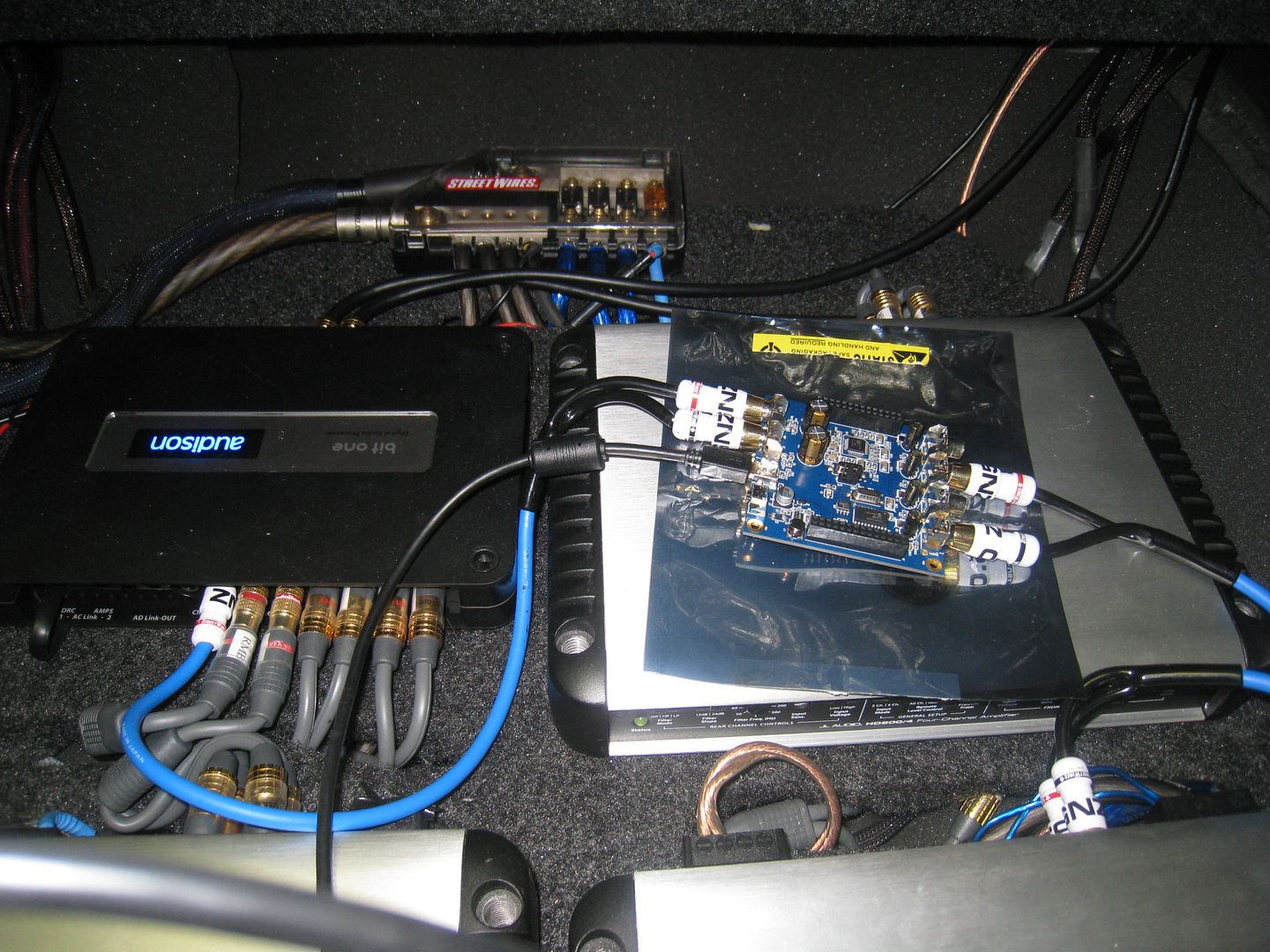

And here it is, sitting in my car:

Alternator Whine/Ground Loops:
Due to the layout of this board and the fact that the grounds of the RCAs are seemingly tied to the power ground, there was concern from many others on whether or not this would result in alternator whine or ground loop issues. Unfortunately, I didn’t have the adapter piece to connect to the board’s power harness to check this via a hardwire. I can’t say for sure if you’d have this problem, but it seems you would.
There are two ways to power this board, though: 1) hardwire, 2) USB power.
To combat this potential for ground loop by hardwire, I simply ordered a USB cigarette lighter adapter. The reason is two-fold:
  1. Much easier to power the board with a single cable. USB car adapters are cheap. I bought a ‘fancy’ one like the one linked below and it was still only $15. I can hardwire this to my car, too and hide the wiring, making it a nicer look overall. Amazon.com: Multi-Use Vehicle Charger with Dual USB Ports and Dual 12 Volt Sockets - Magnadyne: Cell Phones & Service
  2. I would have run a cable to the board up the front of the car for front seat tuning with a laptop anyway, so there were no extra steps required anyway for me. If this is not an option for you, then I would consider at the least making sure that your headunit, amps, and miniDSP all share a common ground. At the least.

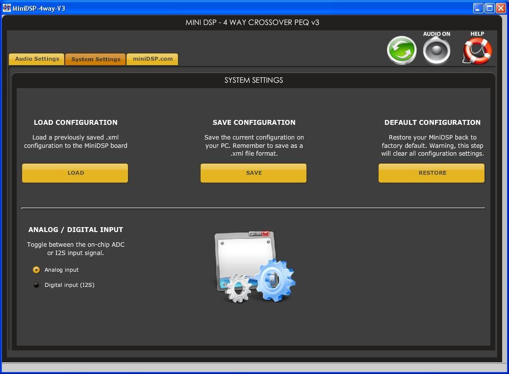

Also, I notice that when I save the settings the board, the 'refresh' symbol is deactivated, and the only way to active it is to 'x' out the air program notifier (which tells you the status of the board/comm). When I do this, it shuts off communication to the baord. It seems that whenever I save the settings, that's all I can do unless I close and reopen the software. This could be a glitch on my end, but I've noticed it happens with both the 2.1 and the 4-way PEQ versions.
Reply from Tony:
With regards to refresh symbol, it's not really a refresh symbol but more a "Connect to" symbol. When you click once, you gain access to the board AND synchronize your current plug-in settings to the board.
After that, you are live connected (live changes) and any changes you make are applied to both the memory of the miniDSP AND the setting file in your PC. There is no need at all to click save or refreshing anymore, because all your changes are applying real time to the board and will be recalled the same if you were to reboot the board right after that change. The save function is ONLY to save if you want to keep a backup on your PC, that's it. Hope this makes sense.
