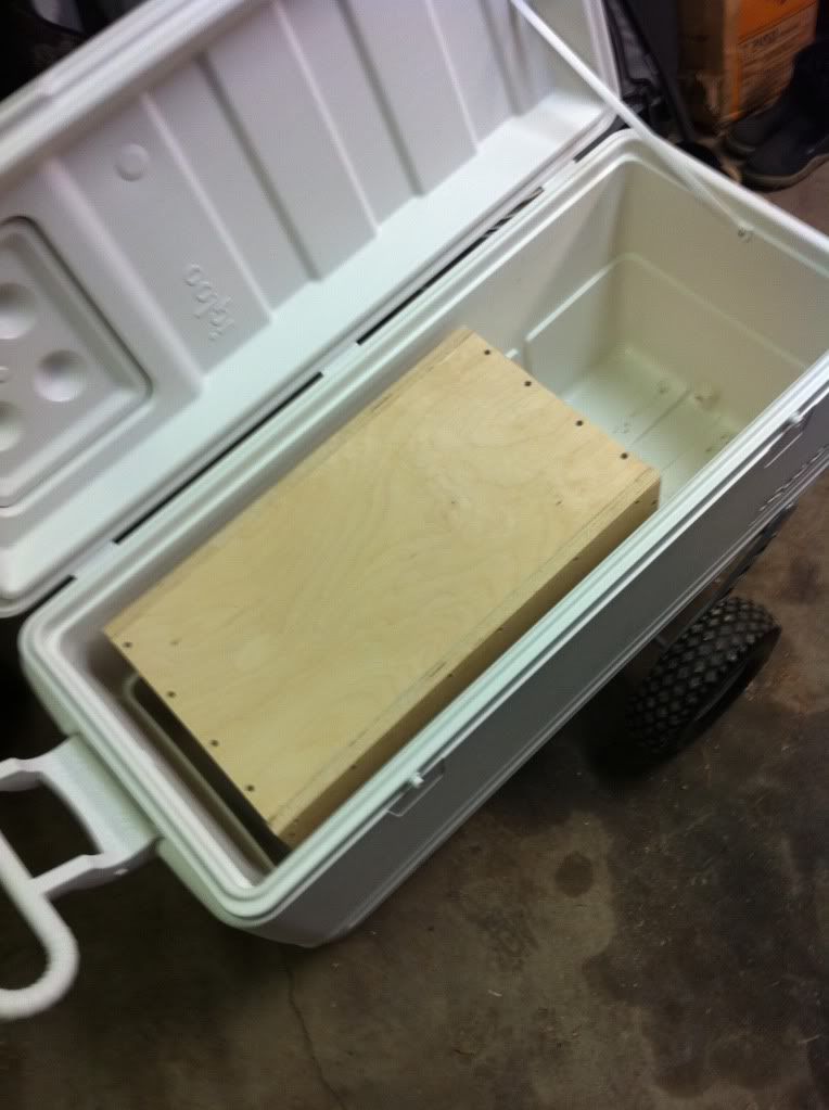

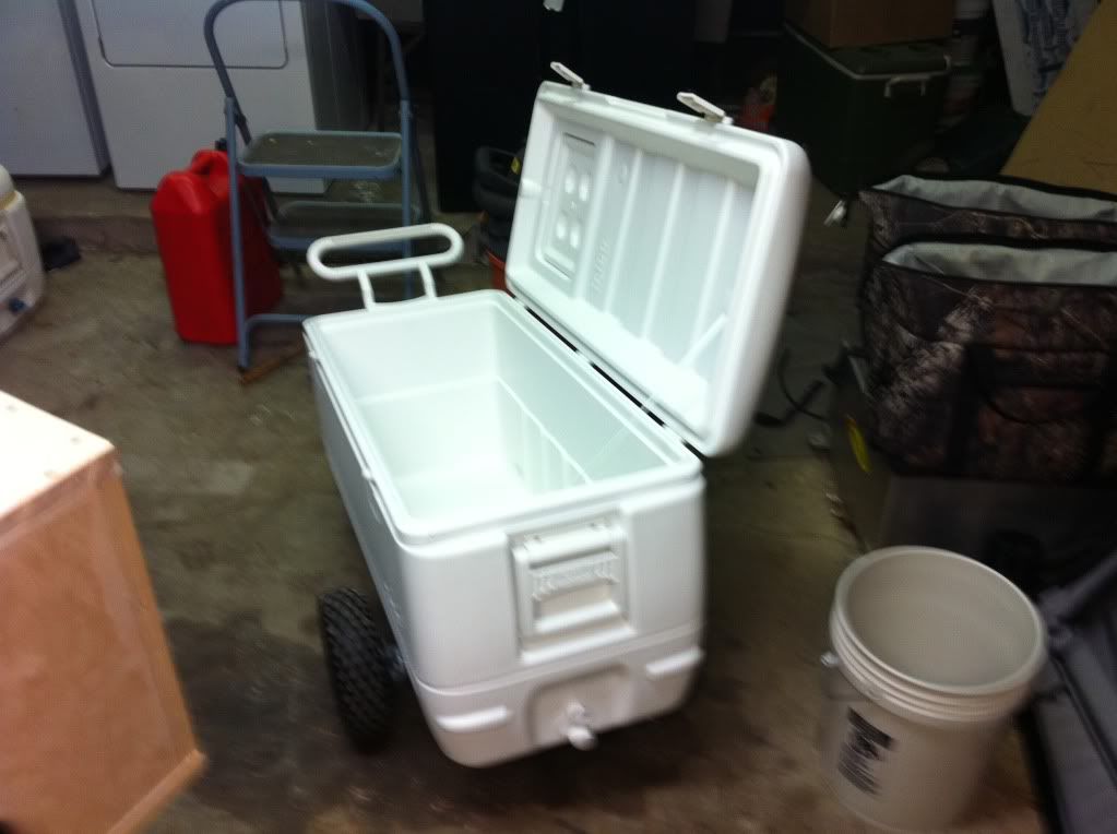

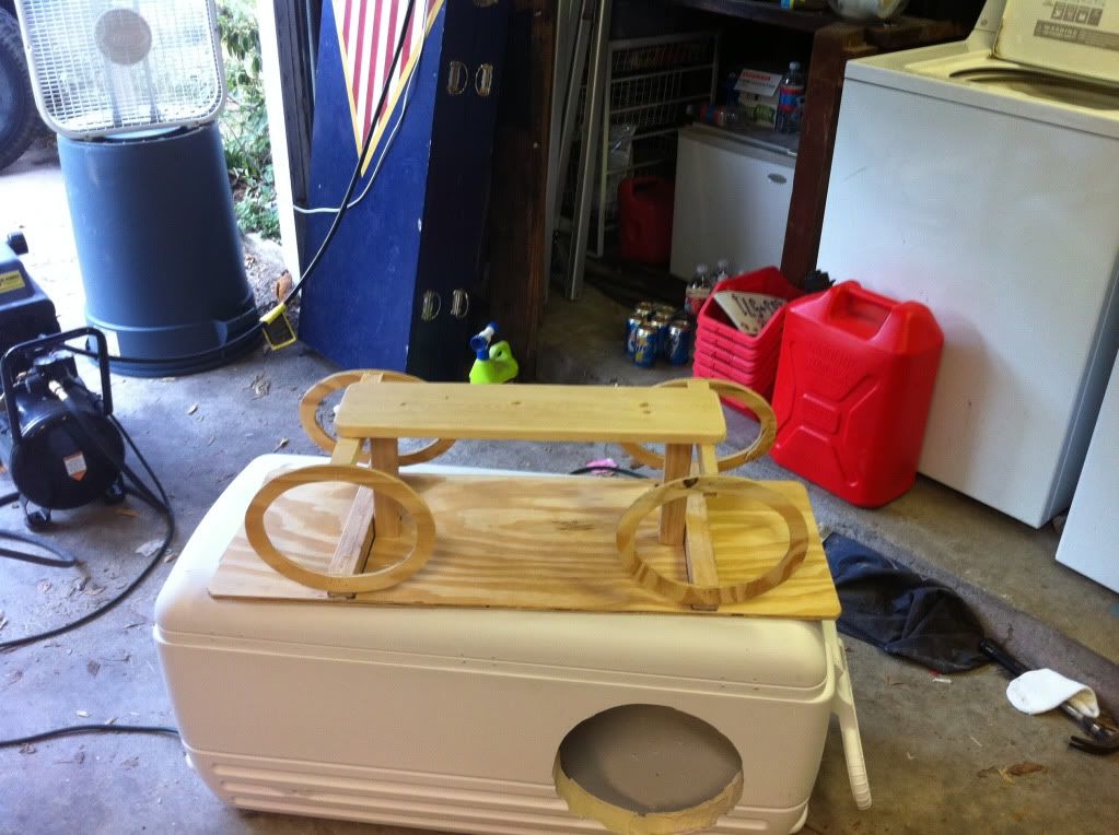

The host cooler 150qt big boy.

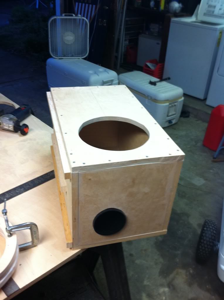

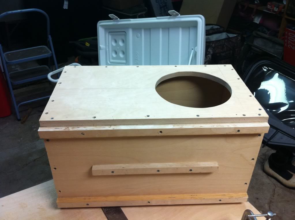

Sub box built for 10" sub, hole cut for 4" port.

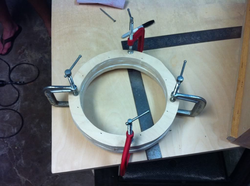

Spacer ring being made for cooler wall pass through.
Checking the line up for where to cut the hole for the sub.

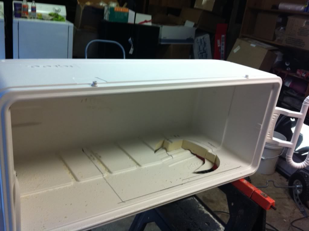

Cut the hole for the sub.

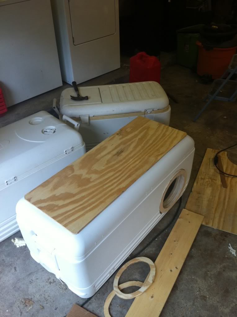

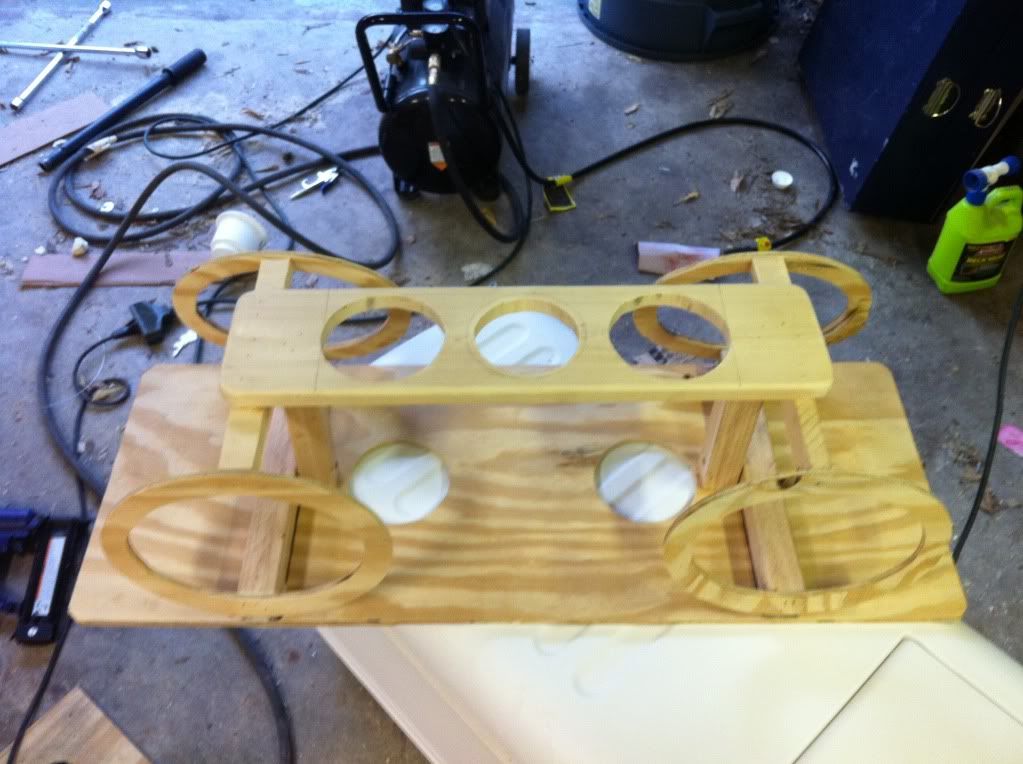

Cut out top wood base for fiberglass speaker pod.
Cut out rings and top cupholder bar and mounted to base.
Coming together
