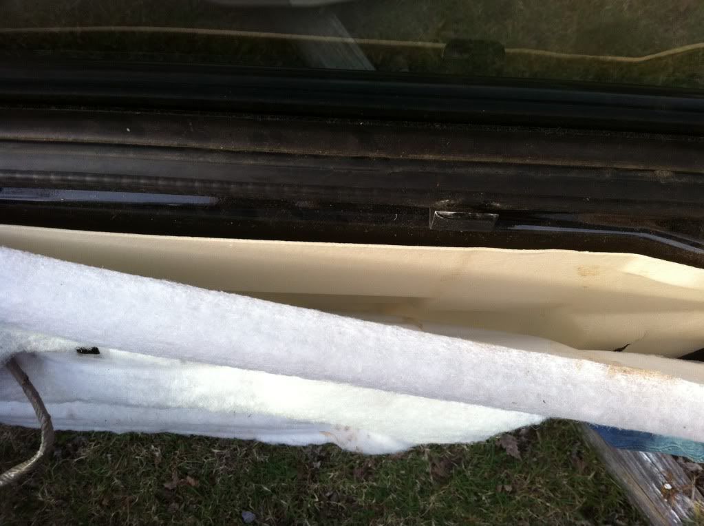

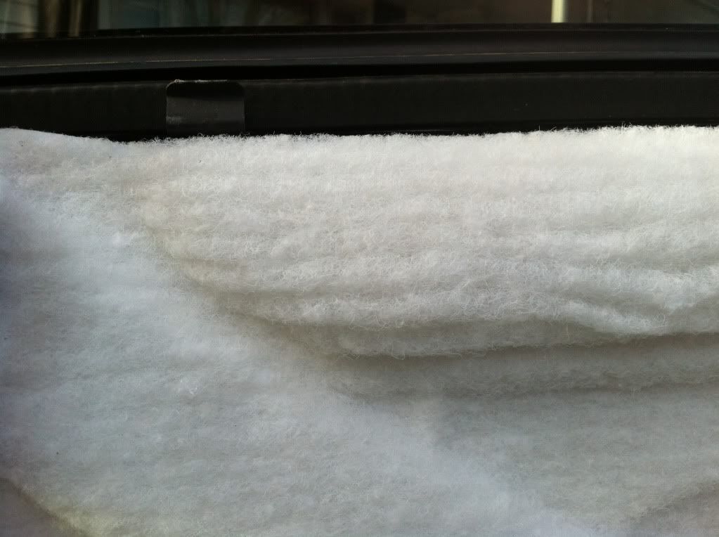

Long time lurker but still in full-blown noob status. I love all the advice everyone gives so, anything said will be listened to. A while back, I deadened my trunk and lid of my '04 Impala SS with Raamat BXT II and it definitely made a difference. I am now going to upgrade my coax in stock door locations and put in SR6500 separates in the doors and pillars. I certainly have read all the material on the benefit of deadening doors so, when I do the change out, I think its something to consider.
However, I have never had an issue with rattle or noticeable (extreme) outside noise. Pulling my door apart, I see that the manufacturer has taken what I believe to be decent steps to avoid some of this. (See pics) I am not considering sealing the doors. If I were to deaden, I'd probably use sheet metal for the large holes and the 25% rule with about 20 sq. ft. of Raamat for both doors. Would I be wasting money/resources with what I have compared to what the 25% would do or would there be a palpable difference in the effect by going with products specifically made for audio applications? As always, all input is appreciated and I hope this question is not too dumb for this thread. :D Happy Holidays!
866 Posts
u dont neet to use metal to seal the doors, u can use the deadeing material
when i do vehicles like yours, I keeo the cotton batting like stuff and throw away foam stuff and use deadening material in its place
if ou do that you will still get excellent results
846 Posts
So basically replace that foam mold with deadening material and put the thick white material back on top of it?
846 Posts
Discussion Starter · #5 ·
Thanks for the advice man. Sounds reasonable.

572 Posts
I have some advice on the doors...
I'm working on my '03 IMPALA and gutted the whole car so I could make the car as quiet as possible to outside noise, which in turn means it will also keep the sound in the car where you want it.
Out of everything I did, the most noticeable improvement was the MLV I added to the doors. Take that white moisture barrier and lay it down on a piece of MLV, trace it out and cut to the same size, including the slots that are on the original piece. Draw a line on the new MLV where the silicone was applied to the original piece, this will seal the door when you put it back together.
Replace all the plastic "Christmas Trees" that need it (I replaced them all) and put the white barrier back on the door panel.
Drill out the holes in the MLV for the "Christmas Trees" with a 1/4" hole drill bit and then cut three 1/4" slots on each hole so you can slip the trees into the holes. Now install the new MLV layer on top of the white barrier with the "Line" you drew for the silicone on the outside.
On the inside door skin, use a CLD both above and below the support beam, 2 strips of Rattletrap worked fine for me, for about 35% coverage. Now Apply a layer of CCF to the bottom portion of the outer door skin, behind where the speaker is located to cut the back wave.
I used the factory plastic baffles and simply added 2 pounds of non hardening clay to each to give them alot more mass. Look in the heater isle of any home builders supply. It's cheap and worked perfectly.
Before you re-install the door panel, apply silicone to the trace line you drew on the outer surface of the MLV, this will effectively seal the large holes in the metal door. Allow the silicone to dry overnight for best results.
I have the Polk MM6501 comps in the door/A-Pillar and have no rattles of any kind. I mounter the tweets about 4 inches from the top of the pillar, aimed almost perfectly off-axis, just a little bit towards the from seats and my sound stage is amazing.
You know how when your driving down the highway and come to a portion of road with a barrier wall, and you can hear the exhaust noise echoing off the wall and directly into the car... that is totally gone now. This was the best "Bang for my buck" out of any of the deadening I installed.
Three sheets of MLV will do the four doors, since the back doors are shorter you can get 2 out of one sheet. I used a fourth sheet inside the back of the back seat. I noticed before that when I had the back seat down, the road noise was no louder then when it was closed up. Now when you close the back seats up, you can't hear the exhaust nearly as much. I did put a high flow exhaust on though, so mine is much louder then stock.

846 Posts
Discussion Starter · #14 ·
sqnut-I'll probably be getting them in a few weeks. I've got to get clear of Xmas and my daughter's birthday the 2nd week of January to clear some money up. My dad actually had two sets of these (one that he put in a car of his) and he harped about the break-in period as well. He has an oscillator so, we're going to throw the speakers on that for a few days to loosen them up. I've got the 4 channels on my Memphis bridged to the fronts and, when I did that, it made all the difference in the world so I plan on putting all that power on these as well. No matter how much people speak against it, I still like rear fill. I keep it mostly faded to the front unless my son and his friends are in the back but, I don't like it when it's completely gone. That may change with better fronts though. Either way, I've got the rears on a small Arc so, it won't change the power the fronts get.
hilander999-Thanks for that walk-through. I wasn't wanting to get into sealing the doors but, after seeing your pic, I'm kind of wanting to. It would be a shame to waste the guide you just gave me, especially since it's specific to my vehicle. :)
572 Posts
The firewall and floor are already pretty well protected from road noise and vibration from the factory, the remaining three verticals (doors and rear seat) are not even close. There was an amazing cut in outside noise after the MLV was added.
One correction I need to make to the walkthrough above, is that you must attach the "Christmas Trees" to the mlv with the spikes on the same side as your line for the silicone, then attach the white barrior to the mlv, and install the two pieces to the door panel as a single unit. It will be tight, but it will not rattle. Normally you would want to use a layer of ccf between the metal and the mlv, but the factory white barrior makes everything for tight enough that there is no movement from the MLV.
Also note that if you do this, you cannot tighten the screw that holds the door handle cover on the whole way or the automatic locks will not move enough to lock and unlock the doors. Simply tighten them a little and then back them off untill the locks work correctly, I was worried about vibration from the loose screw, but have not had any vibration at all so far and it's been 4 months now since I added the MLV.
Since we are esentially sealing the mlv to the metal door skin, you are closing all the wholes with the single piece of mlv instead of trying to cover each hole individually so this really was the lowest cost, easiest way to treat the doors for this specific vehicle. Figure about an hour per door if you work at a decient pace. It's not dificult at all, just time consuming so don't get in a hury.
Make sure you have a razor blade and a very shap pair of sissors to cut the MLV with. A cordless drill and a 1/4 hole drill bit (used for wood) worked perfectly to make the holes for the christmas trees.
The back seat is really easy, simply remove it from the car and there is a slot where the material is conected together at the bottom on the back side. Open it up and slide a sheet of mlv between the plastic seat back and the fabric, then seal it back up. Cut 2 small pieces for the sides and hook them into the foam with the plastic pins that hold the fabric down.
846 Posts
Discussion Starter · #16 ·
Man, I really appreciate all the pointers. You've made this pretty easy on me. Thanks for all the time you put in explaining that. I'm not sure I need to do the back seat because I already did the entire trunk but, if it's that simple, might as well go ahead and do it while I'm working on it.
