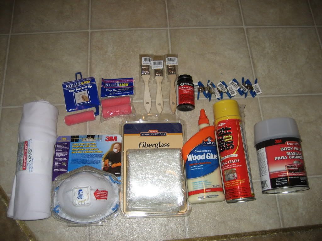

I also went shopping tonight for build material
Fabric Remnents :)
Found this ruler type thng in the quilting section of a fabric store. I'll use it as an outer ring so that I can make a compresion fit speaker grill. Got this idea from BigRed's hybrid build log.
7
I've also got some resin somewhere. Not in the picture.

Take that bondo crap back. Then look up Rage (Rage Gold, Rage, or Rage Extreme) online or nearby. This will save you HOURS of work.
I've used the bondo filler in the past and it did require tons of sanding. I'll have to see if i can find some of the rage products. Thanks for the heads up.

I'll be interested to follow this as well. I've used the Bondo glass and regular bondo in the past. Is the Rage stuff that much better?
I called around for rage gold products and found a place that sales it but it's like $30/gallon.
I'm not in a race to finish this so I think I'll stick with the bondo filler and just do a bit more sanding. I will be covering the pillars with more fabric if I can find a close match to my headliner/pillar material so it doesn't need to be perfect a few pinholes shouldn't hurt.

Looking good! Definetely go with the Rage Gold, $30 its worth every penny when you see how easy it is to use.
