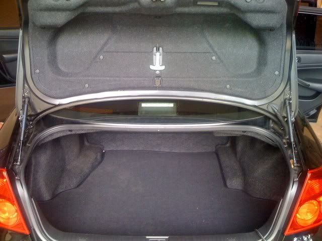

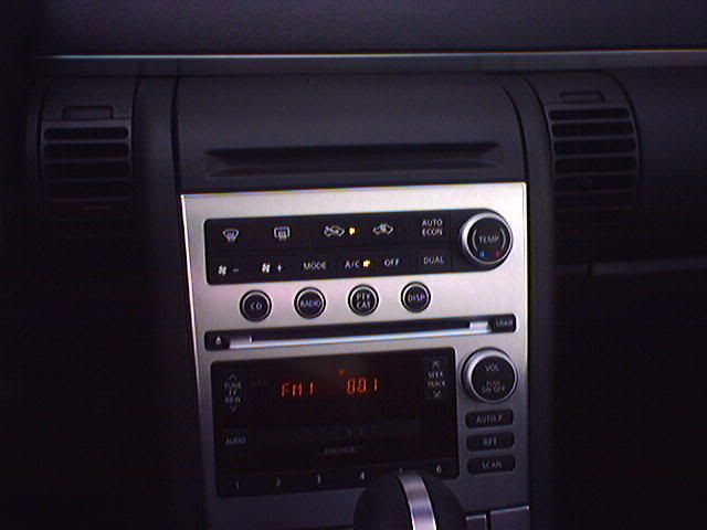

though id share my build 4 my best friends g35 i did/doing. Its a simple and clean build nothing over the top is what he wanted. He didnt want to change out the factory headunit at the moment due to the fact he didnt want his car broken into.
EQUIPMENT
optima yellow top
BIG 3 under the hood
Rockford Fosgate 3sixty signal processor
MB Quartz Components in teh front
JL Audio 300/1
Jl Audio 500/1
JL Audio 10w7
He didnt wanna go with a box in teh trunk looking install which would look kinda of tacky in a 30+K car so we choose to go with a wall set up. The box is 2cu @32hz and ports up threw the factory bose 8" cut out into the cabin.. The build will start with the trunk and work its way to the front and to the engine. Hope you enjoy and i will post pics as they come

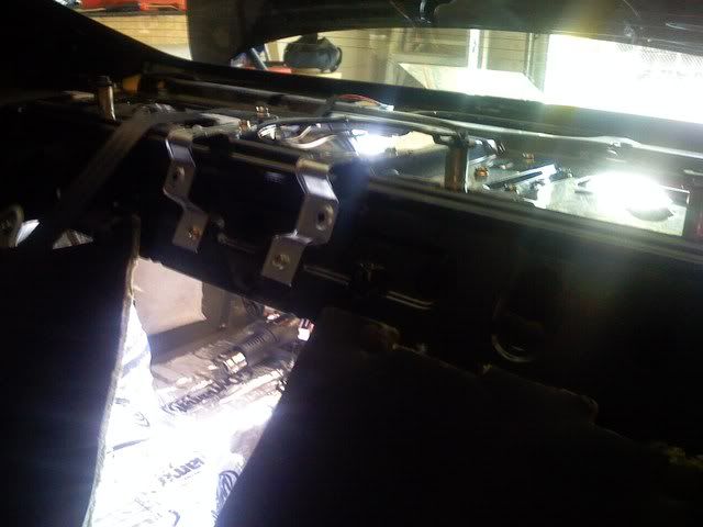

3sixty take the place of the factory bose amp

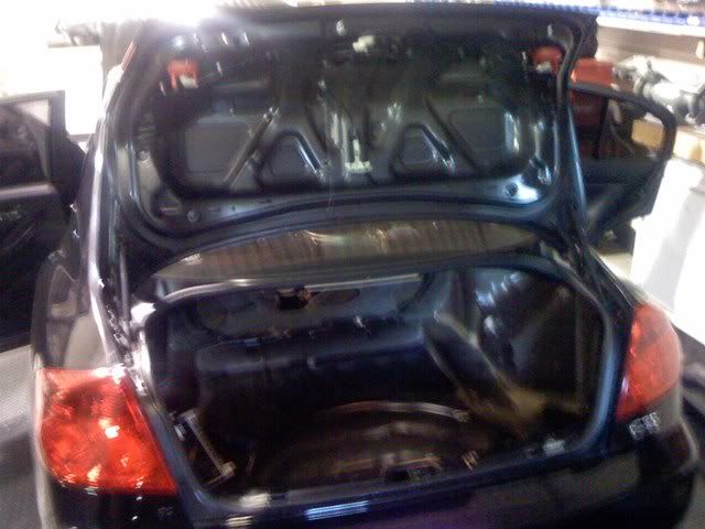

all in all about 3-5 days the first full day was stripping the car down and adding dynamat and getting the speakers pods cut and doing the whole bose wire diagram and testing input and output 4 the 3sixty. The second day was building and wiring and the rest was putting everything together, waiting for different supplies to come in and tuning and checking and re-checking so he wouldnt have to come back 4 a careless mistake.
