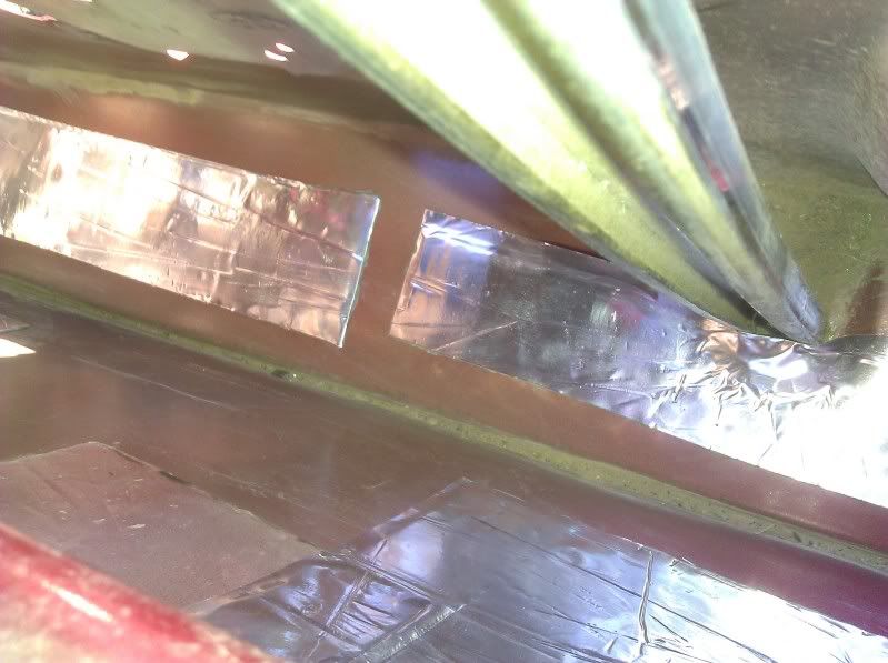

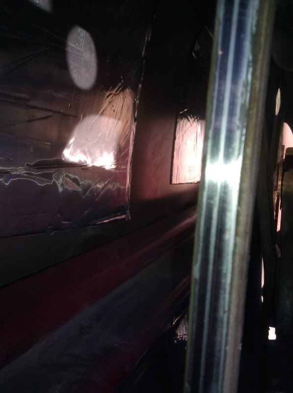

So far, I have only had the time and weather to install some CLD on the outer door skins. I probably have about 50% coverage and I am amazed at the results! I can definitely tell the difference when driving, they don't ring like they used to when I go over bumps in the road, and when closing the doors. I mostly focused on the large flat areas.
