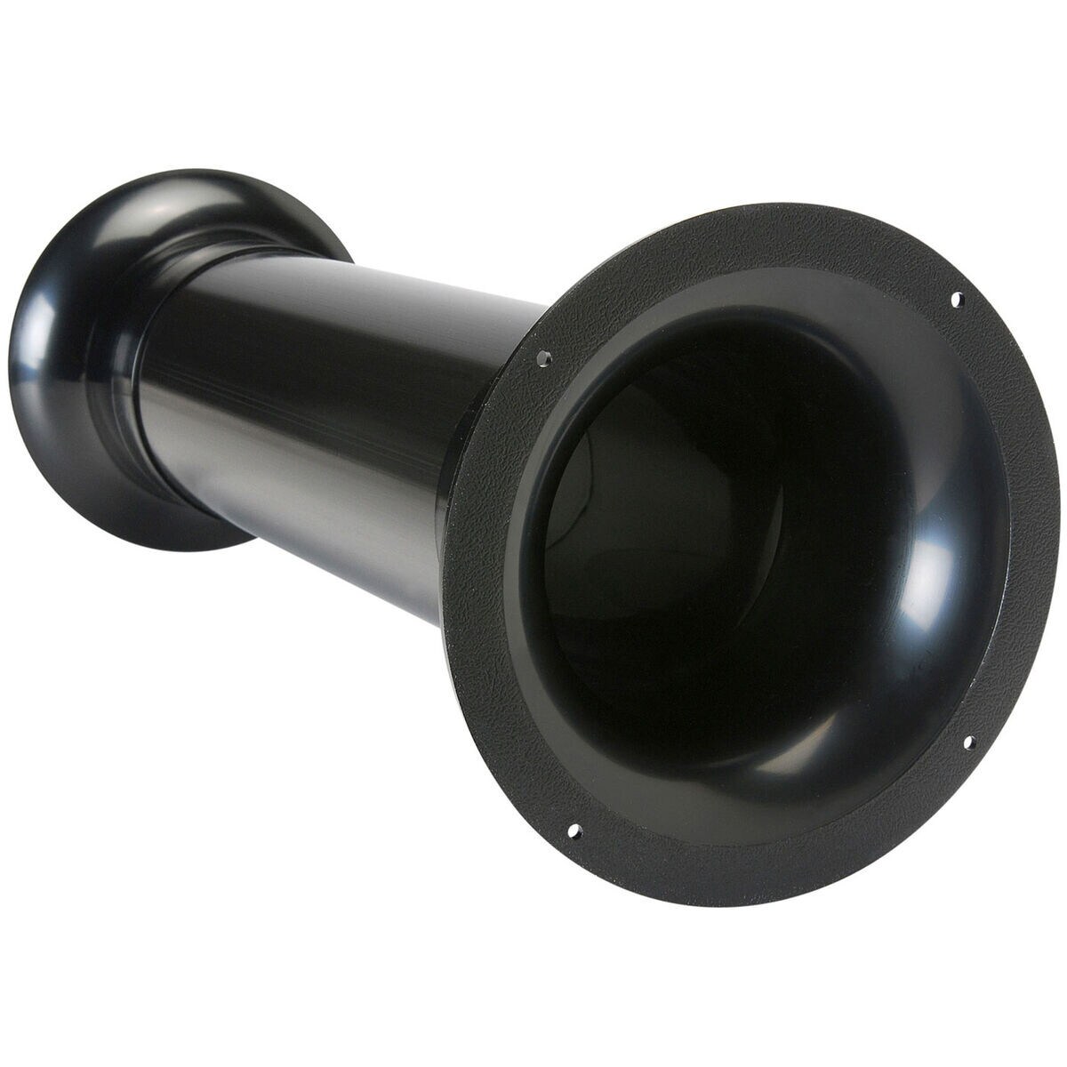

A flared port (tube or slot) will allow higher port velocity before the onset of port noise / chuffing versus non-flared counterpart. Generally speaking, apart from slot port area height-to-width ratio beyond 10:1 or so, there is little or no inherent difference in terms of sound or performance between slot port and tube port of equal area and length.
I am partial to modular flared tube port kits like this though, for minimal port area (and length) and relative ease of trying different lengths to see what sounds best:

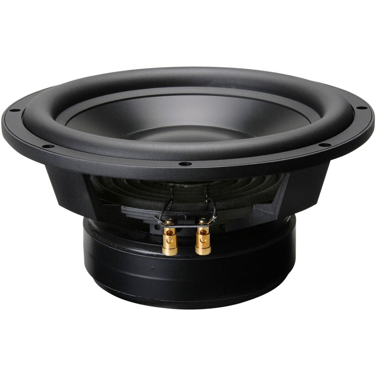

This is an awesome SQ sub, and one of the very few D4s, and it's on sale right now for $220:

Here's that Dayton HO-44 in 1.5 ft^3 at 25 Hz = 24.5 Hz F3 (excursion at 700 W):

Yes, and I have first-hand experience with it. Only trouble is it's a small-box sub, so for the above alignment it needs a long slot port (for example, at minimum port area,1.25" x 10" x 33"):
