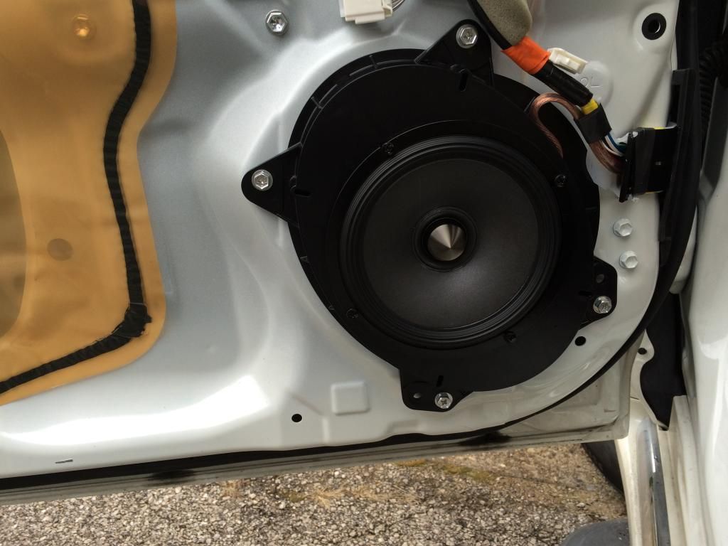

Out of curiosity, anyone know how hard it is going to be to run speaker wires into the front doors?

Toyota doors aren't bad.

I just want to update this thread and say that I am very happy with the way my budget system performs. I did add an EQ to get some adjustments since the factory head unit is limited on tuning options. I am really looking forward to building a new enclosure later on and I certainly need to add some sound deadener to the doors and tailgate.
Anyway, for $600 (plus the EQL) I really don't think I could have done any better.
The best part, the bike still fits. :D
