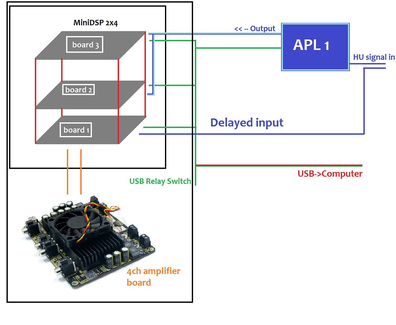

After lots of planning and experimentation I will use the Vifa TG9's in a dipole config. It gives a better perception of space. It also makes the sound harder to locate which is good for rear-ambience-fill. The P99 got 11,5ms of delay and the MiniDSP board got 7,5ms IIRC - so in total 19ms cascaded. That should be enough. Adding a classD board chip amp from Ebay, those amps are actually quite ok for the task (driving the rears). Since there's no way to connect the MiniDSP boards and use them as one unit (same software instance) as far as I know - I'll add a USB switch so I can tune the APL and the three boards from one computer using one cable.
Here's an ugly schematic of what I'm attempting to do:
