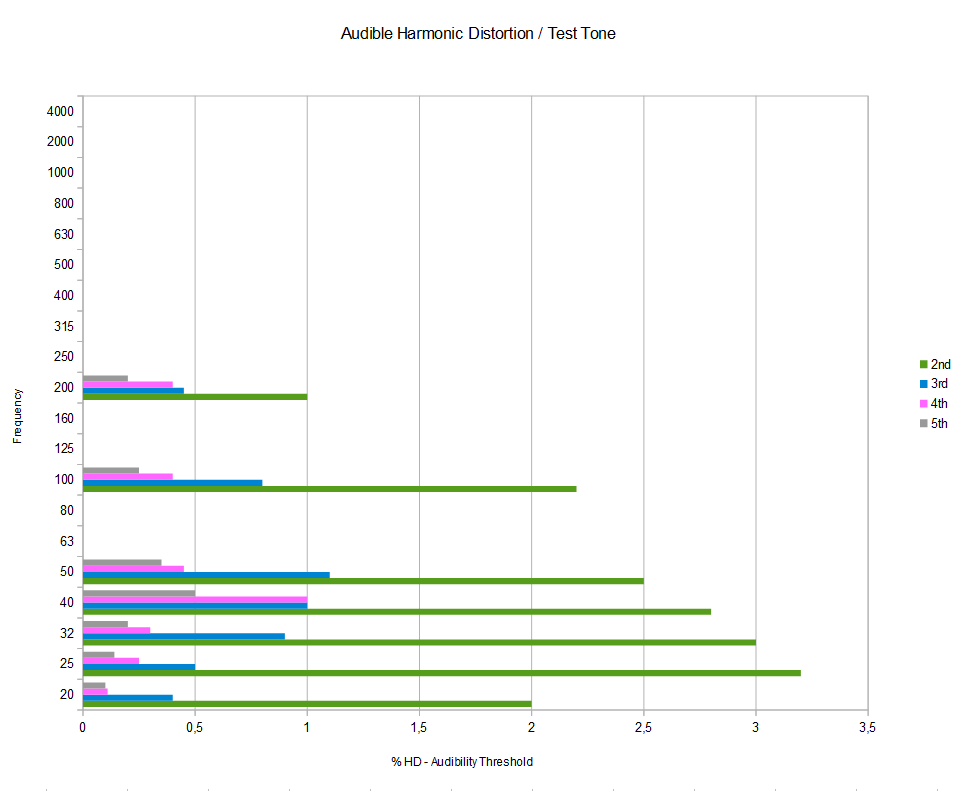

Did a test tone audibility test with a few minutes in-between. The audible distortion levels are lower than you might expect in the lower frequencies. This is with test tones, so the music audibility threshold will be higher of course, but with music there will be a lot of IMD distortions as well. I really believe a low distortion sub sounds better, low frequency distortion IS audible.
