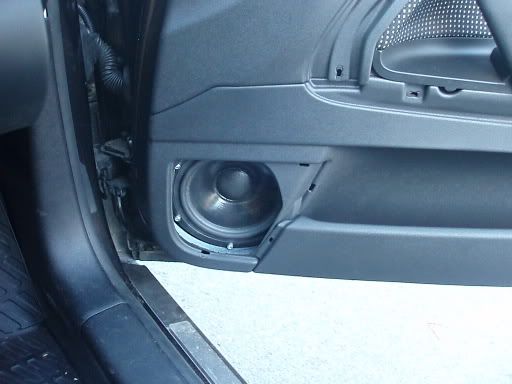

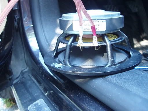

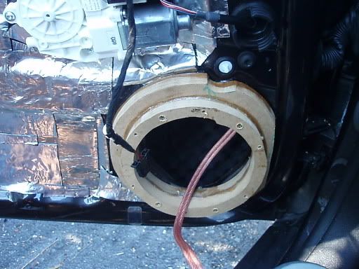

That door setup looks very much like my R32 door. The inner door skin is one piece of aluminum isn't it? It makes a great sealed enclosure for the mid! I like the very stock looking install. Good work.
#8 ·
The inner door is one peace, but you can se a plstic piece, but this is sealed with some sticky rubber-thing. The mids sounds great in hear. The car could be a tad more deadned..but...maybe later when i got time and money.
I made two rings out of MDF, one that just fited the driver, and one wider to stick on the door. This is actualy glued with some kind of allround sealer/glue thing (almost like silicone)
