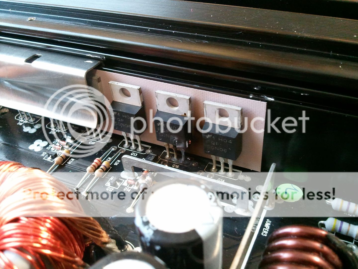

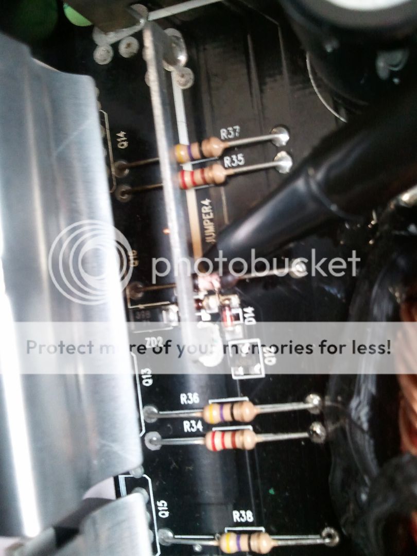

Alright, I did all of the above, and it still did the same stuff. It even kicked off sound when in acc this time. But i was only able to get it to do that one time. So pulled the amp and yanked the back cover off. Not sure if this would make it do what it is or not, but it cant be good. Here is what I found:
#14 ·
Minbari, I figured as much. This amp doesnt owe me anything. I have had it for years. I am currently searching for a replacement and will probably put this one up for sale, or just toss it out.
#15 ·
Damn it looks like you are going to be doing some shopping :)
Sent from my DROID BIONIC using Tapatalk
#16 ·
Already on the way ;). Boston Acoustics GTA-1105 and a ID10 S4 V3.
I am going to attempt to fix this one myself though for a backup. Just have to order a couple of parts.
