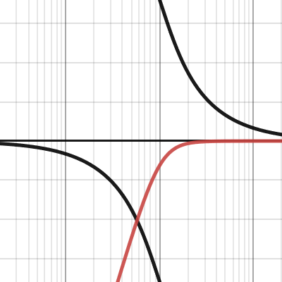

I'm a big fan of Mark's videos (this is the video you guys are talking about, I think), but my numbers don't agree with his (around the 9:20 point). The first-order Butterworth is down 7 dB at 50 Hz, not 6 (ok, that's pretty close). The 2nd-order is down 12 dB at 50 Hz like he said. The 4th-order Linkwitz-Riley is down 48 dB at 50 Hz, though - not 24 like he said. Maybe someone can check my math though.
#11 ·
I haven't looked at the videos you linked, but I compared the chart you made above to the charts in Vance Dickason's Loudspeaker Cookbook and also my excel spreadsheet. Your 1st and 2nd-order Butterworth curves look correct at 100hz and 50hz. Your 4th-order LR curve is much too steep though. At 100hz it should be -6dB (and it is), but at 50hz it should be almost exactly -24dB (my equation puts it at -24.6dB). I'm not sure what you're using to plot the red line.
Also, when making charts, try setting the x-axis to log scale instead of linear.
Well, I got it fixed, but I'm not sure why. In my equation, I was using 'w' raised to the power of 2 * 4, with the 4 since it's a fourth-order crossover. But changing that to 2 * 2 gets me the correct results. Not sure why?
I tried setting the x-axis to log scale, but Excel tells me I can't do that for negative numbers.
