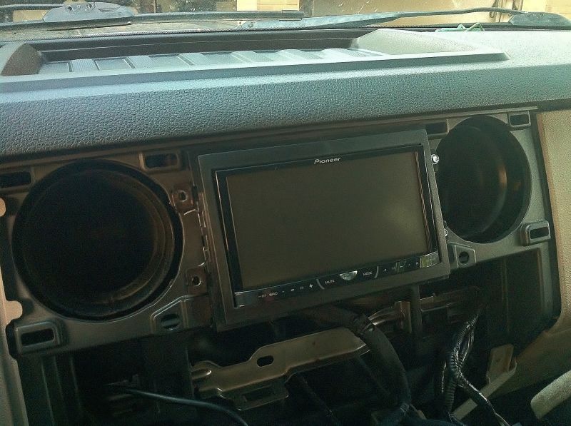

The headunit, amp, and rear coaxials are mounted.
The front speakers have not yet been mounted because I have never installed a set of components before. I'm thinking of mounting the crossover in the door and putting the tweeters on the sail panels. While my truck did not originally come with the OEM tweeters, the trucks that do have tweets from the factory have them mounted in the front sail panels. Does this sound ok?

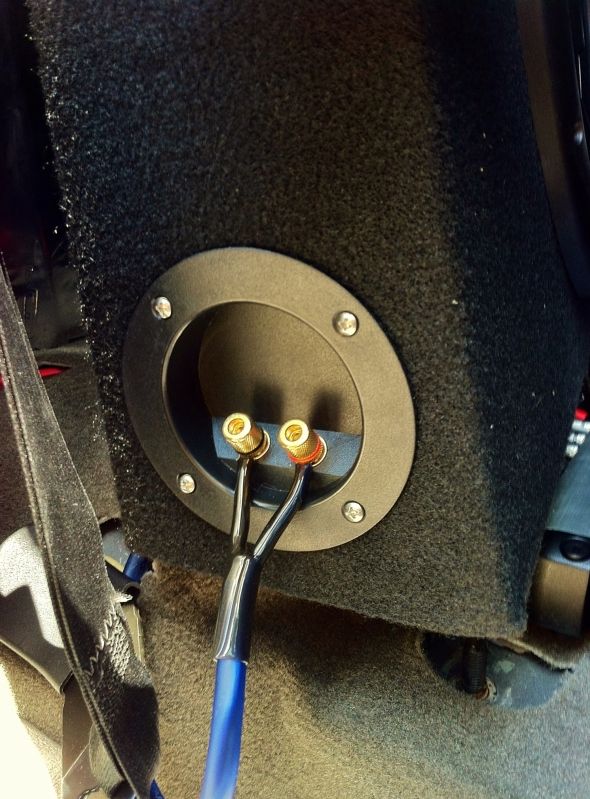

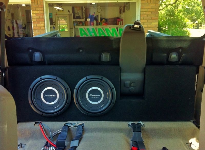

The sub box and subs have not been installed as I'm waiting on delivery. How should I wire them up? I'm thinking I would wired them into a 2ohm load, right?

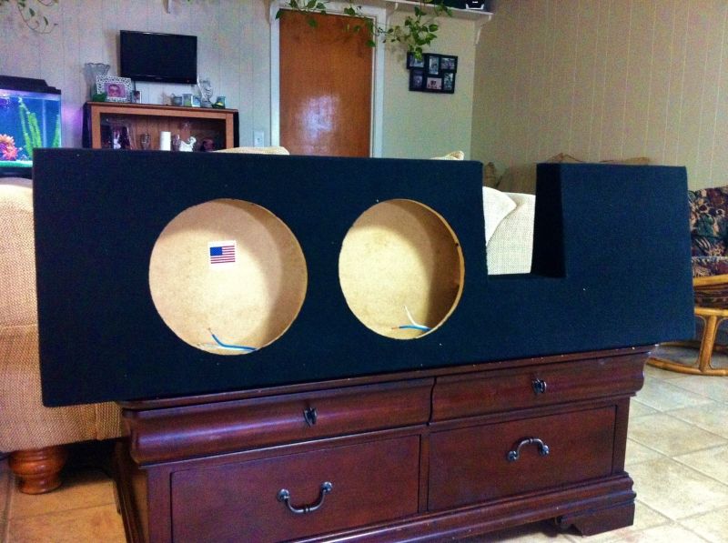

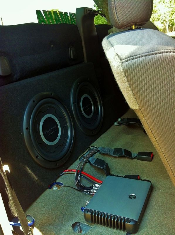

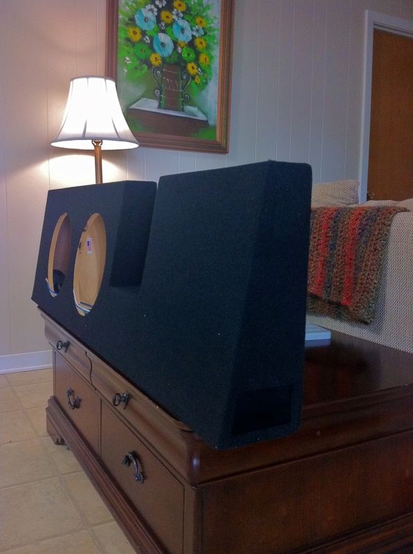

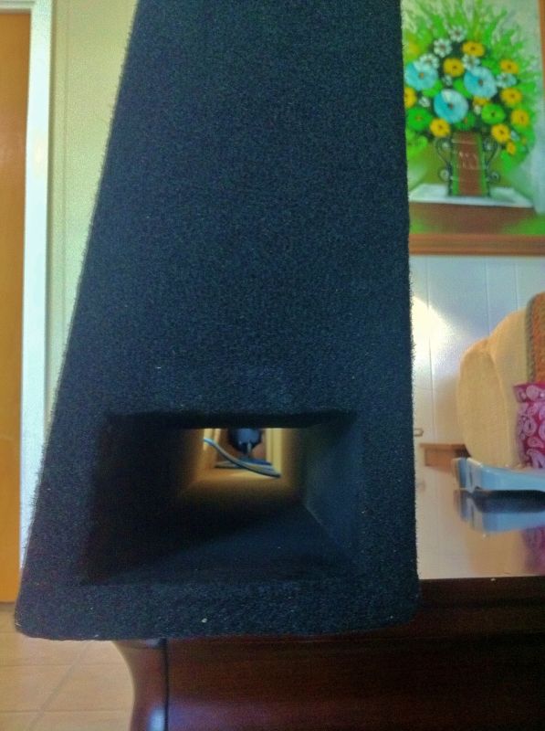

I got my box from SPL2K today. It is beautiful. Michael does excellent work and seems to be well regarded in the Super Duty world. My box is ported and holds two 12" Pioneer shallow mount subs.
I have a few reservations about whether or not the sub channel of my HD900/5 can push two of the woofers which claim to have a 400w RMS rating. With only 500w on the sub channel, the subs will only be getting roughly 1/2 of what they are rated to handle. But Michael seemed to be confident that they would sound great, especially since I went with the ported enclosure. We will see what happens in a few days when I get the box installed.

As for sub wiring, your JL's sub channel is rated to 1.5 ohms, so you are correct; wiring them in parallel for a 2-ohm load is most likely going to work best.

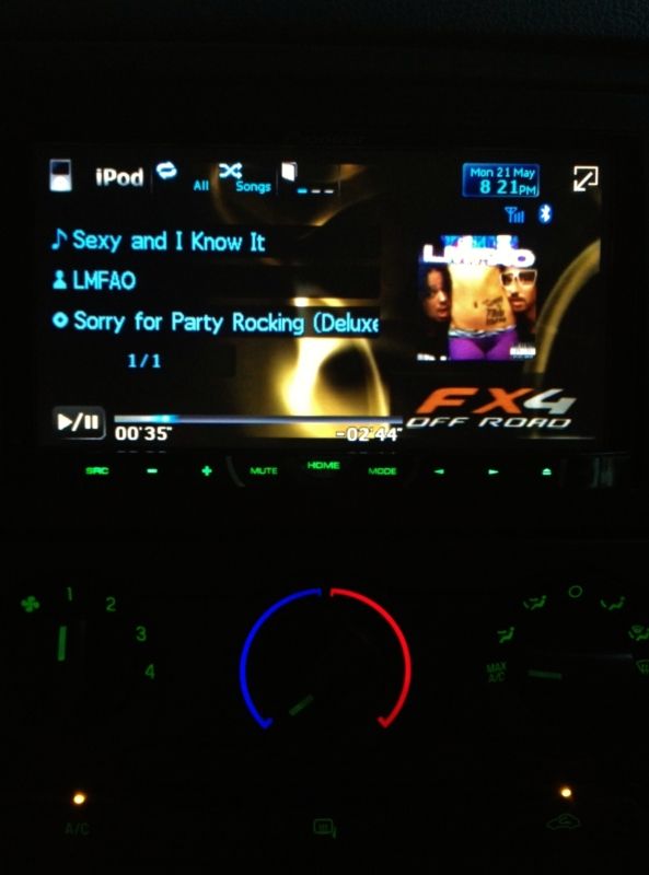

I have a question now.

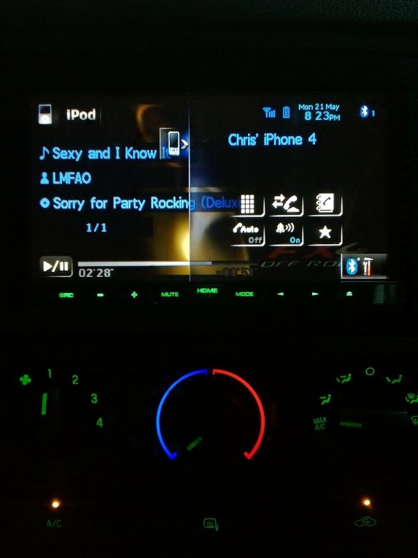

I seem to be having some issues with my subwoofer control on my headunit (Pioneer AVH-4400). The headunit has the ability to turn the subwoofer on or off. When you turn it on, it allows you to adjust the crossover frequency, adjust the sub level, and shift the phase 180deg. My problem is that the subs play regardless of whether or not the sub control is on or off!
Furthermore, the subs don't respond to adjustments to the Low Pass filter or the level control options on the headunit.
They do respond accordingly if I make my adjustments on the amplifier (JL HD900/5).
The subs seem to react to adjustments I make to the headunits High Pass filter. They get louder if I shift the crossover lower (like 50Hz) and softer if I move the frequency to, say 125Hz.
Is it possible I have an RCA mixed up on the back of the headunit? How can I tell?
The proper speakers play when I fade to each corner of the vehicle. Would that be an indicator that everything is hooked up correctly? Also, the rear speakers in the headunit are set as "FULL." If I set them to subwoofer, they stop playing. Would this also be an indicator that things are wired properly?
Aslo, my remote level control works normally for the subs.
As it sits now, all the High Pass and Low Pass filtering is off on the headunit and done by the amplifier. I have the front and rear door speakers set at ~75Hz at 12dB and the subs crossed at ~80Hz at 12dB.
Everything sounds decent at this point, but someting has to be off with my wiring or with my RCA hookups because the subwoofer control on the headunit isn't responding properly. I feel like I might be leaving a lot on the table if I just leave everything as it is and just run it. Thanks for any pointers.

I figured out my problem.
Oops!
I had my amplifier set incorrectly. It needed to be switched to [6 Channel] mode and I had it set to [4 Channel]. My bad!

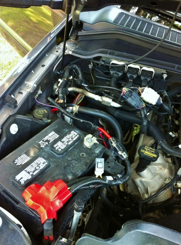

I terminated the wire with a ring terminal. The Ford batter has a connector with several bolts on it for the OEM connections. I unscrewed one of the nuts and installed the ring terminal. I the connection looks pretty solid.
Here are a few more progress pics for this thread.
This is the underhood wiring.

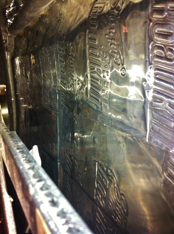

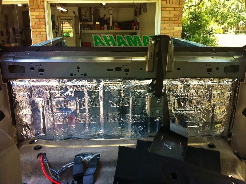

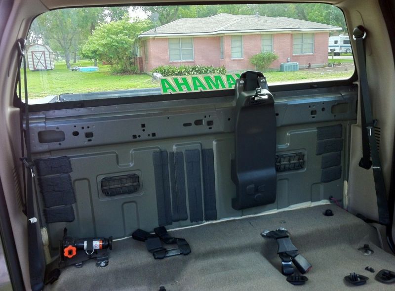

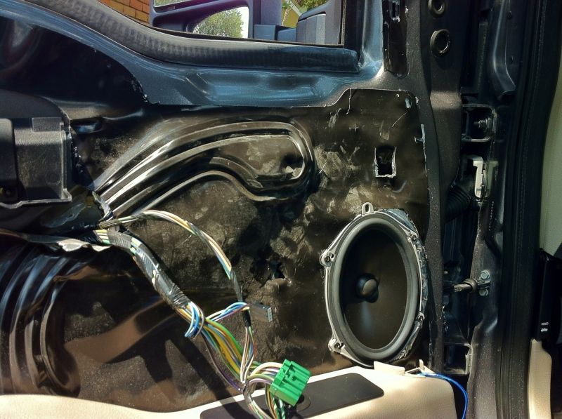

This shows the inner door skin getting a layer of sound deadening.

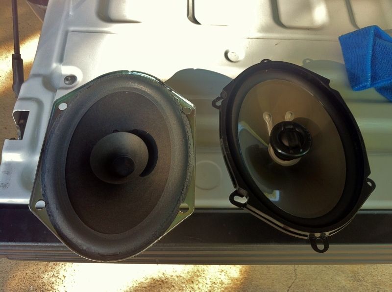

Here's a comparison photo of the OEM Ford speaker and the JL C2 570x I used in the rear cab pilars. The factory speaker has a paper cone. Wow.
This shows the vapor barrier reinstalled on the front door. I also installed about 50% sound deadening coverage to the outer door skin that is not visible in this pic. You can see, however, the JL C5 570 woofer in the stock location.
The door panel reinstalled and the tweeter mounted. I wanted to flush mount that tweeter so bad, but I don't think there's enough clearance behind the sail panel.

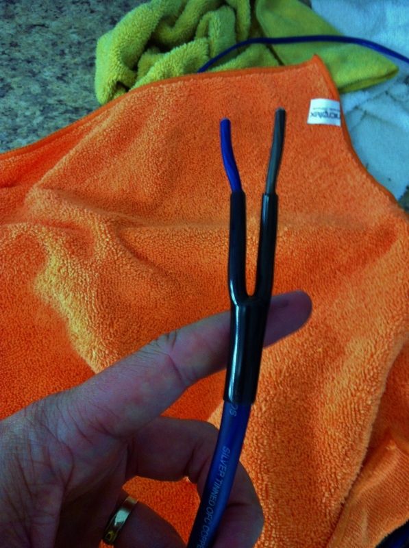

I've never seen speaker wire pants before, lol. But I used them. The Kicker wire is nice. It's 12ga that goes to the subs.

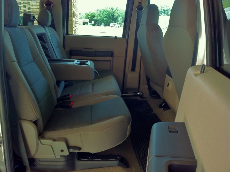

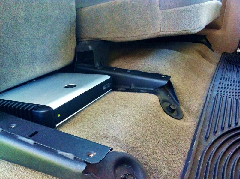

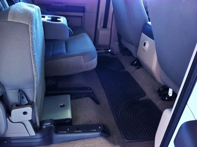

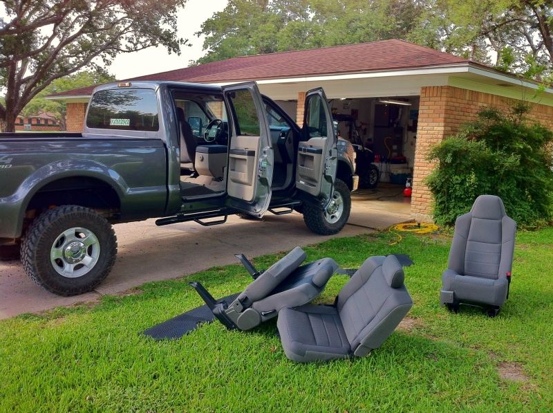

Here's a final shot of the amp mounted to the floor of the truck and the rear seats about to be reinstalled.
Finally, here's a finished view of the rear seats. No leg room was lost, and everything looks factory in the back.
