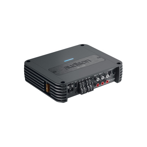

While I was hunting around for a few items I came across some decent pricing on Class D Audison gear which might fit the bill for your setup well. These should sound good, make enough power and are very compact considering the output. Down the road a bit you could easily add a DSP and another 4 channel to drive your front stage fully active.
Audison SR 4.300 D-Class 4-Channel Amplifier 85 Wrms X 4 At 4-Ohms - $259.00
Audison SR 1.500 D-Class Mono Bass Amplifier 1000 Wrms X 1 At 1-Ohms - $278.74

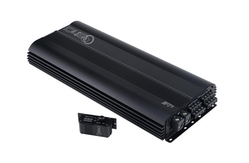

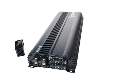

I personally have no experience with D4S products, but the power they provide for the price is pretty crazy. They have a 5 channel for less than $400 with 900 watts on the sub channel. I would probably go with these amps over some of the other off brand products. They also have a 7 channel for less than $700 if you want to try running active in the future.
  • Power Dynamics:
    • 900W x 1 RMS power at 1ohm for CH5
    • 200W x 4 + 700W x 1 RMS power at 2ohm
    • 120W x 4 + 400W x 1 RMS power at 4ohm
    • 400W x 2 RMS power at 4ohm when bridged
  • RMS Power Ratings:
    • 1ohm (CH7): 2000W x1
    • 2ohm: 190W x 6 + 1600W x 1
    • 4ohm: 120W x 6 + 1000W x 1
    • 4ohm Bridged: 350W x 3
Reactions: iamkickingback

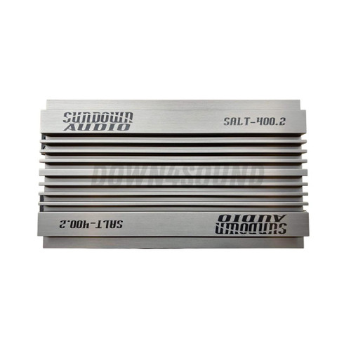

Sony XMGS4 GS Series 4/3/2 Channel Hi-Res Amplifier (Black) https://a.co/d/aNLoGMC
Run your subs in series like this
Bridged to a 400.2
