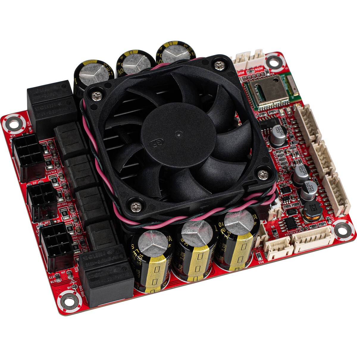

This is a higher end option, probably better to do justice to your hard work, and a very nice integration etc:
#8 ·

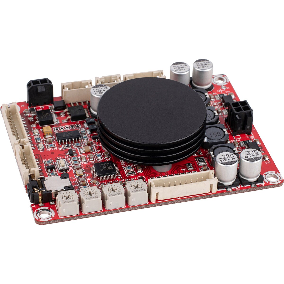

Good option at only $80 or so.
Worth remembering that all these small boards need something to program them. That Dayton needs a specific development board, the one I linked a RPi. Probably Sigma Studio knowledge as well (not sure if there is some easier options with the RPi)
I'd still 100% recommend those DSP plate amps though. Actual DSP UI, PSU built in, great quality Class D amps, neat mounting, SPDIf in and speaker link.

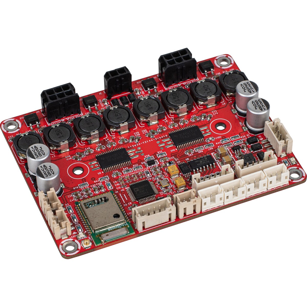

I guess they added some 4 channel options.
#12 ·
this is looking doable... 4100, dspb-icp1, their power supply, then just whack it all on an aluminum sheet, use laptop to tune, and viola, cheap, powerful, active 2-way stereo set up?
