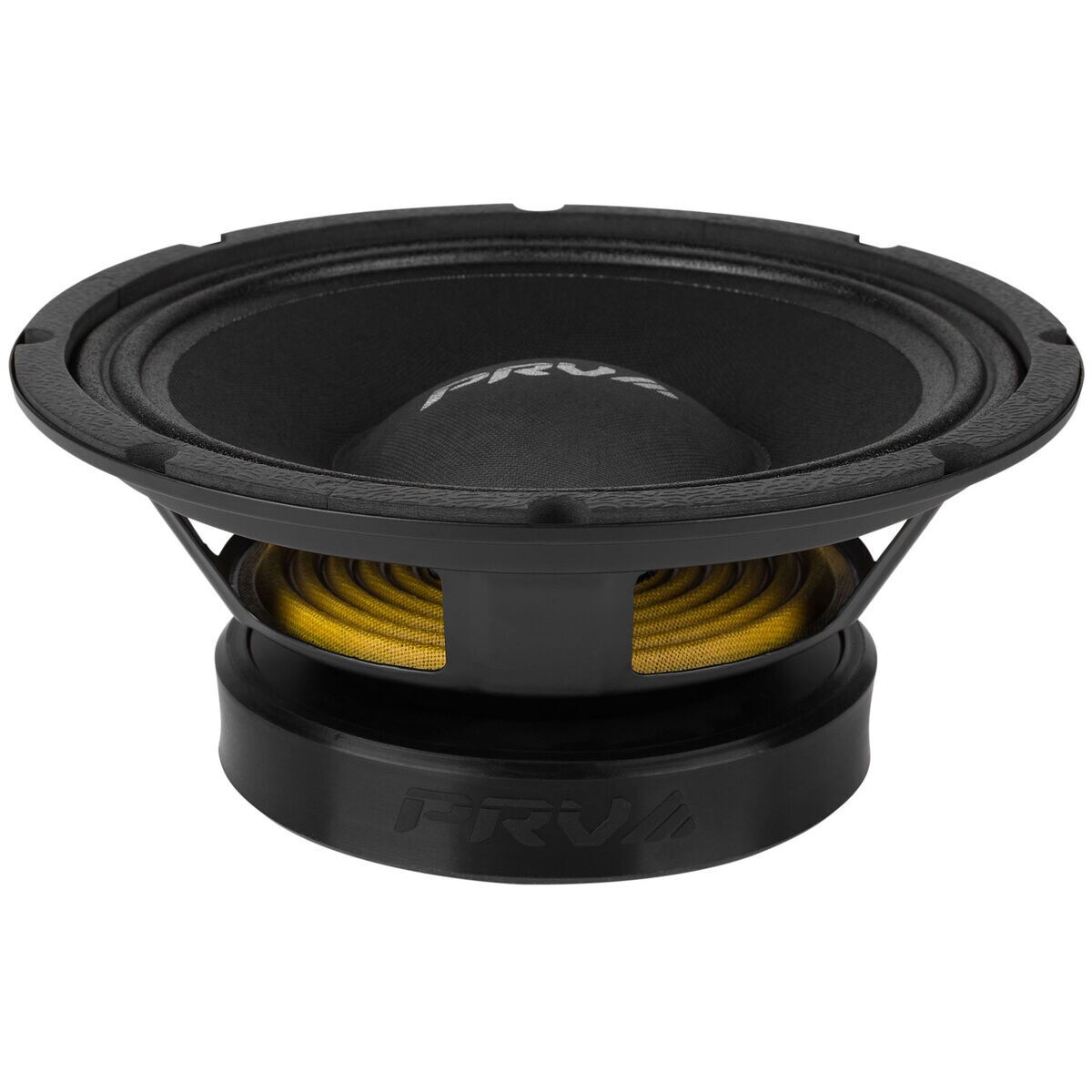

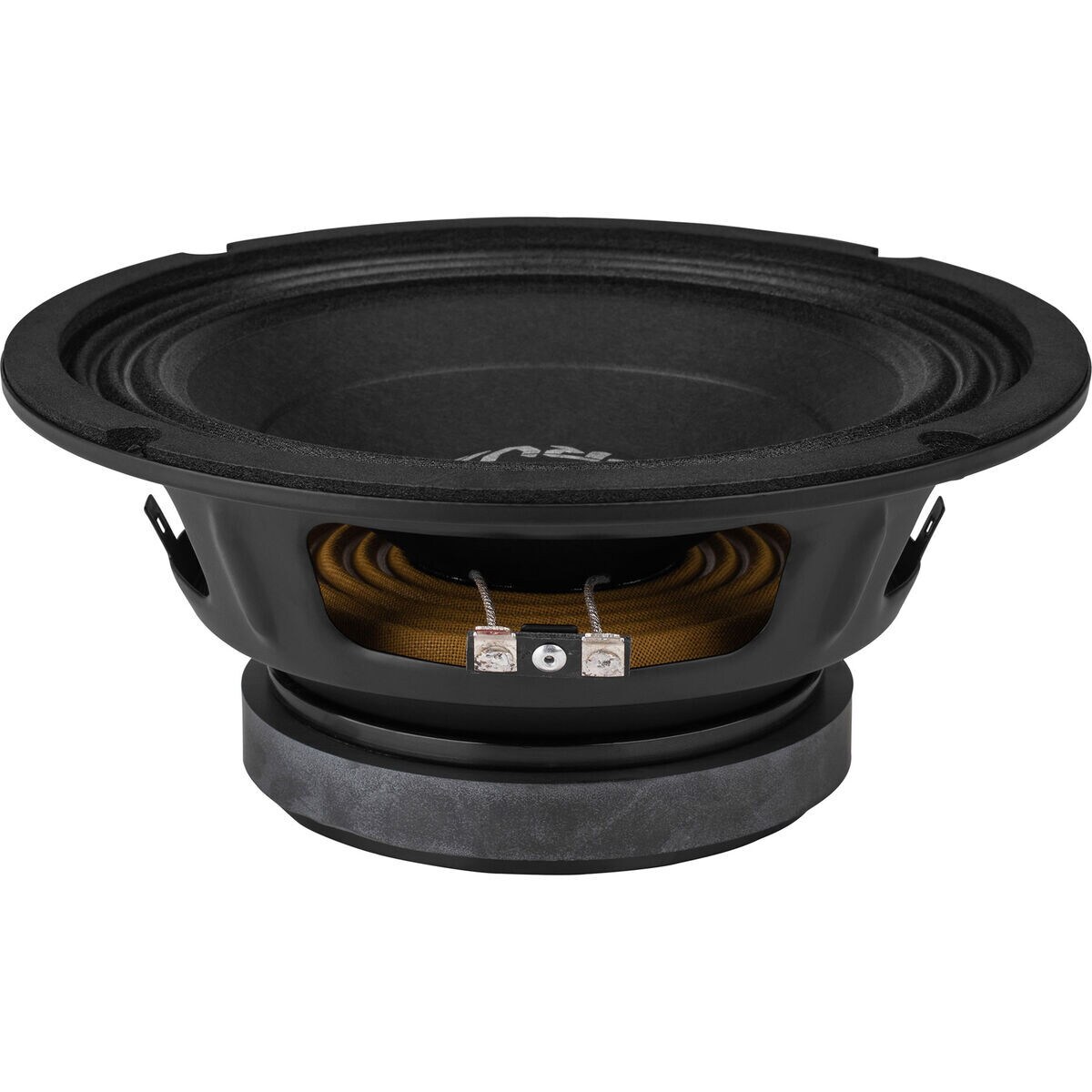

Hey now.... anybody know anything about these ???
And honestly, I love my 18" Skar Audio subwoofer, so maybe these ?
And btw, while the top driver here is listed as a mid-bass speaker, the frequency range starts at 75hz. The Skar is listed as a mid-range, but the frequency range starts at 80hz. Not much difference. Yes, I know the numbers on paper don't always say much, but so far I've been really impressed with both my Skar subwoofer, and my Skar 4ch amp...
Edit; Wow, I like the specs on these even better !
Might be a better match with my 18" sub as well. I forgot to say, it doesn't "have to be an 8" driver :) Pretty sure 10"s would fit no problem also.
For what it's worth I run these PRV as my bass stage on my Harley in the bags facing the rear wheel.
I would listen to the other guys with way more experience than me though.

I REALLY like the looks of these ! ....and a frequency range starting at 46hz.... should do 90-300 really well !
Ah.... bummer... 8 ohm :( Unless I ran 4 of them in each door :) lol
#25 ·
Well you saw that the Dayton's were 8 ohm right ? But the 10" PRV's above are 4 ohm, and the specs look good. I will probably get those and install them in the current location in the back, just to test them.... but then I will start some research on building custom door panels, and eventually try to move those up front...
