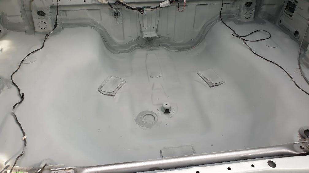

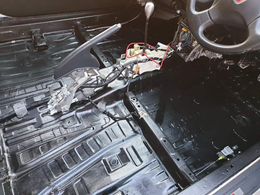

Most of this job was born of the fact that i had a couple a seam leaks. So stripped the interior and did some rust proofing with some Eastwoods Rubberised underseal. And then repainted the boot as its a little easier viewed.

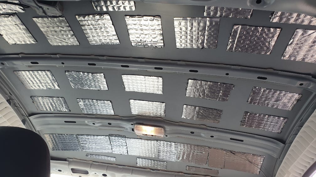

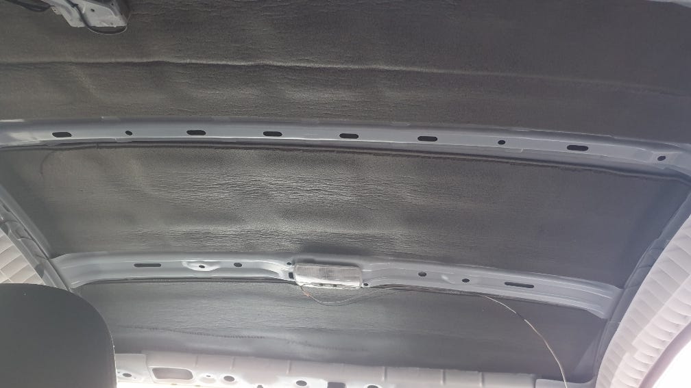

Then onto the roof first. CLD and 11mm Tri Laminate.

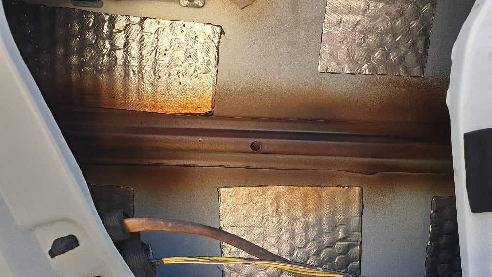

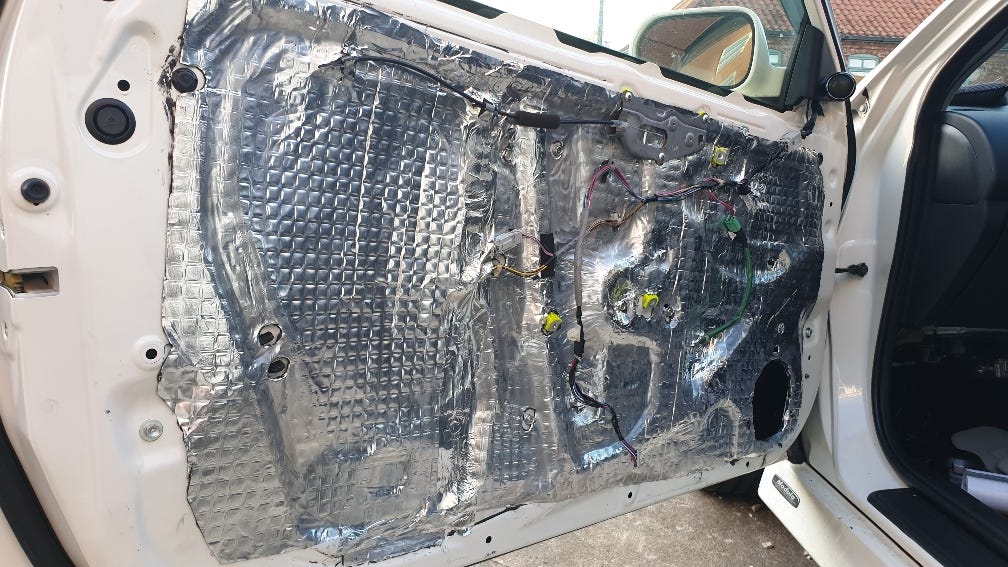

Next I tackled the doors. CLD on onner and outer followed by foam backed MLV. 3mm foam 3mm MLV.
