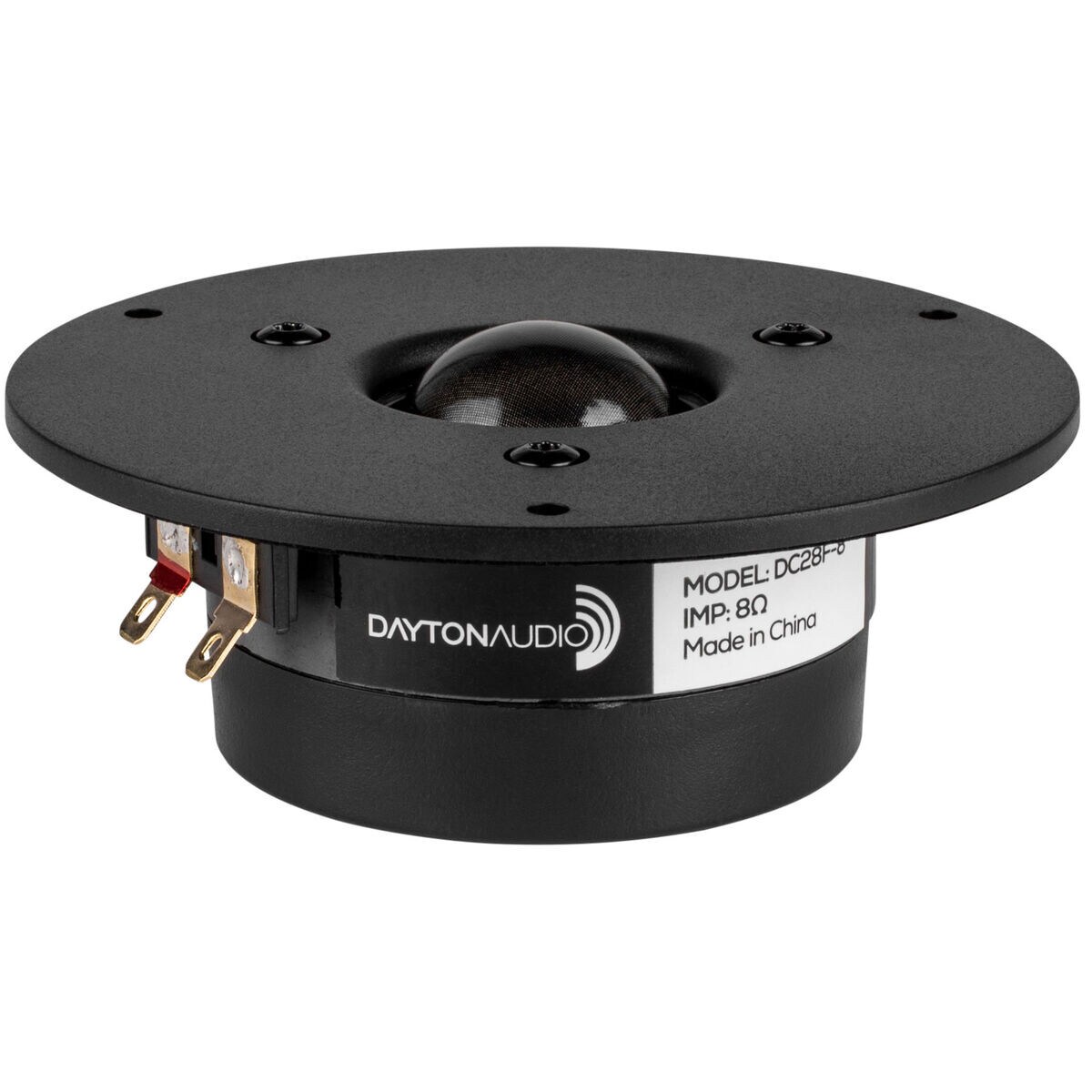

When I ran the RS180 and other similar drivers 2-way (limited by off-axis install in the doors), the most inexpensive but highly effective tweets at that time were Dayton Classic silk which I ran in the dash corners, behind stock grilles, and firing straight up. These are large format but fit in many dash locations where a 3.5-4" nestle. They can take an impressively low crossover point that really helps with upper vocals being planted on the dash or above.
Sent from my SM-G986U using Tapatalk
I used this tweeter in a pod on my pillar for a few months. It was the most detailed yet smooth tweeter I ever heard. I had to ditch the idea because they looked hideous and blocked my view. I plan to make some bookshelves with them some day.
