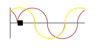

port firing rear close to the trunk lid is definitely a rattle trap but if you have it further from the lid or facing in to the cabin far away from the trunk lid THIS happens. Phase cancellation where you literally lose 3-10 db easy in total output.
