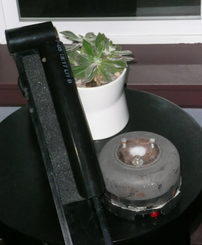

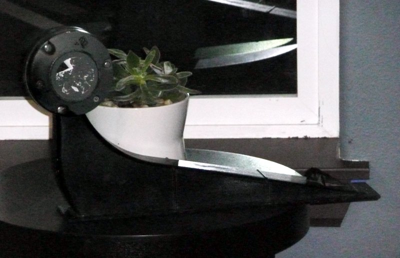

Here's a pic of the waveguides in the Speaker Works Grand National. According to their website, these were the first set. If you look at the compression driver, you'll notice that it uses a "two bolt" pattern. Only one compression driver uses that pattern these days, a company named Radian. (It's possibly an Emilar, but Emilar is no longer around.)
If you've seen some of my other projects, you may be familiar with the horns and waveguides that I've fabricated. I know that horn fabrication is anything but easy. USD Audio sells an excellent set of waveguides, and for this project, I am going to use them. Here is a pic of my set. If you'd like to build the Grand National in a Box, you can get a set of USD Waveguides here:
USD Audio WaveGuide BC-300
Here's a pic of the waveguides in the Grand National. In my car I've found that waveguides under the dash are a lot less obtrusive than kick panels. And there isn't a kick panel in the world that will keep up with the GN (or the GNIB.)

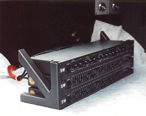

According to Car Audio and Electronics, Richard Clark made a number of improvements to the waveguides in the Grand National.
Even with a set of $2500 compression drivers, the Grand National still required a narrow band EQ. The reason is that the horns have a series of peaks and dips. The EQ is used to fix that.

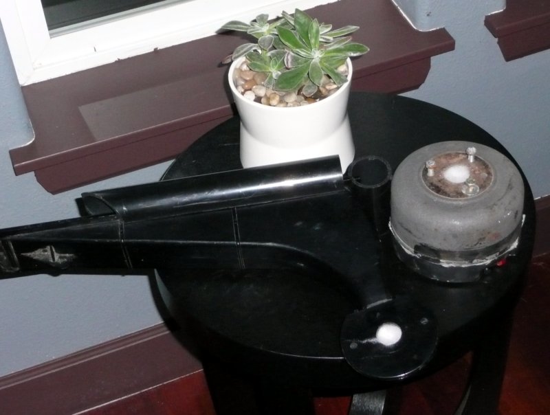

Here's a close up of the diffraction treatment on the USD horn. There are additional pictures in the diyaudio thread.

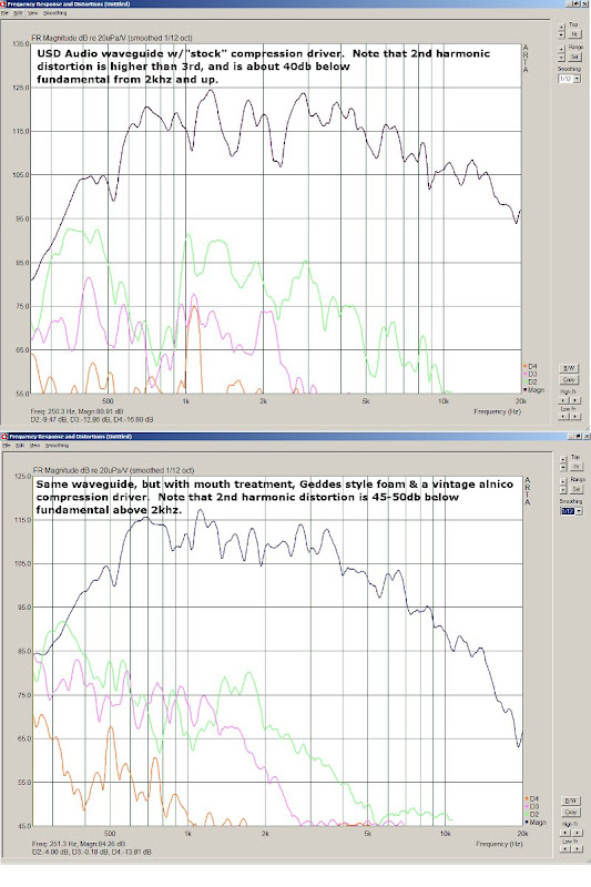

Here's a distortion measurements of the "stock" USD waveguide, along with the modified waveguide.
Most manufacturers don't publish distortion measurements; even high profile manufacturers like Morel, Scanspeak and Dynaudio don't offer them.
John Krutke and Brandon (aka Augerpro) have generously published distortion specs of popular tweeters.* In their measurements, you'll see that a good dome tweeter has distortion that's 20-30db below the fundamental. Now look at the graph above. Even the unmodified horn has distortion that's about 30db below the fundamental, at least above 2khz.
The performance of the Radian is good, but the performance of the USD waveguide with the JBL driver is even better. Above 3khz the distortion is virtually unmeasurable.
The Radian is still very good though. Though the JBL can play lower, it's over twice the size, and the Radian can play higher. It also has an efficiency advantage.
Personally, I prefer the JBL. It has more efficiency than we'll ever need, the response of the modified horn is smoother, and the JBL plays lower with finesse, thanks to it's very low distortion. Note that the 2nd harmonic distortion is very low - this is due to the silver shorting ring in the motor. Even the Altec doesn't offer this feature.

In the CA&E article*, Clark said the following:
"Absorption material was added to almost all the upholstered interior surfaces. Unlike mass damping, which only prevents resonance, the absorbtion material that I chose also reduces unwanted reflections inside the car. These reflections can cause unwanted secondary imaging cues.

In this pic, you can see that there's sound absorbing foam in the waveguide. But why stop there? There's polyfill inside of the compression driver throat, in fact there's sound absorbing foam INSIDE the compression driver's chamber.
Clark had the right idea, he's just going about it a different way than I am. In the Grand National, Clark is absorbing reflections in the cabin. What I'm suggesting is to absorb the reflections AS SOON AS POSSIBLE. As in, right at the diaphragm.
I know it seems absurd to put a bunch of sound absorbing foam in front of your speaker, but it works. The graph above compares how the USD horn performs with and without treatment. The difference between this one, and the one I posted yesterday is that it uses the same compression driver. This helps illustrate that it's not the compression driver that's creating all those nasty reflections - it's the horn. In particular, it's the horn's mouth

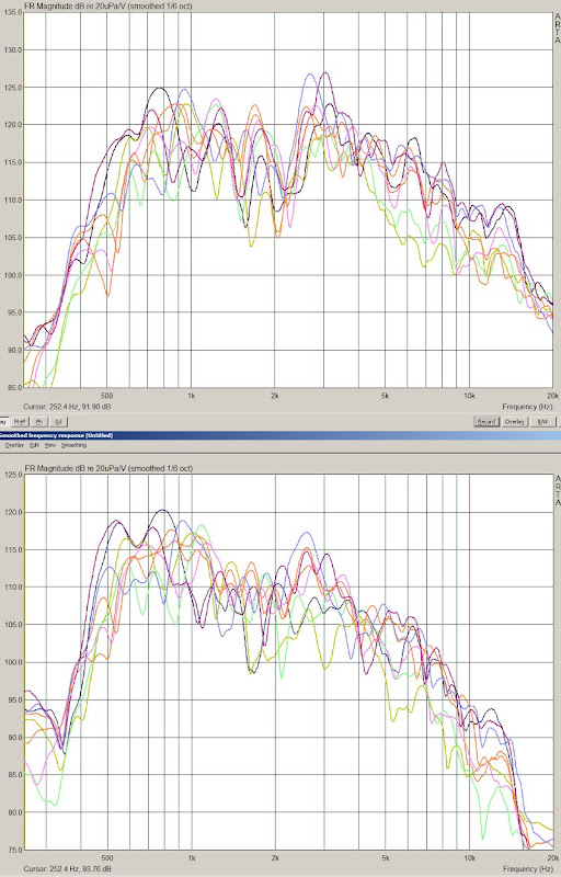

  • The graph at the top is untreated. The graph at the bottom is the treated horn. I shifted the bottom graph by 10db, to make it easy to compare.
  • See that big peak at 2800hz in the untreated horn? But see how it's NINE db lower in the treated horn? What that means is that over FIFTY percent of the sound we are hearing in the untreated horn is due to reflections! How awful is that? With reflections like that, it's guaranteed to audibly color the sound, and create "false imaging cues" as Clark alluded to.
  • Sometimes it's hard to determine what's causing a peak. But the dip at 1400hz confirms that the two are related.
  • In the treated horn, we see the peak is reduced by half. The dip is virtually gone.
  • Notice that the treated horn doesn't have a lot of the weird "squiggles" in the response.
  • Most important of all, note that the response of the treated horn doesn't jump around as much... In other words, the soundstage isn't going to change if you move your head two inches. Accomplishing that goes a long way towards creating an authentic acoustic environment.
  • This diffraction treatment has been discussed extensively at diyaudio, and is inspired by the Gedlee Summa speakers. Good stuff, and highly recommended for the home, theater, or studio.

Here are some measurements of the distortion performance of a "stock" USD Audio waveguide, and the same waveguide where I've replaced the compression driver, filled the horn with foam, and added a roundover to reduce diffraction at the mouth.
In the distortion measurement, you can see an improvement in harmonic distortion with the large format compression driver, and a much lower F3. You may note that the diffraction treatment is having a significant effect on the driver's efficiency.
Some might think that any reduction in efficiency is A Bad Thing, but I disagree. At low frequencies I want all the efficiency I can get, which is why I use tapped horns in my own car. But at high frequencies I'm interested in low distortion and good polar response. I wouldn't care if my tweeters had an efficiency of 85db, as long as they had excellent polar response, could take a lot of power, and had low distortion. As I see it, that's what's important at high frequencies.
Note that Clark treated reflections in the car, and we're treating them inside of the horn itself.
Note that distortion in the 2nd horn is over 40db below the fundamental above 2khz. Check out the distortion figures at zaphaudio if you're curious to see how a dome tweeter behaves. Note that my distortion figures are skewed higher because they're done in a car too.
