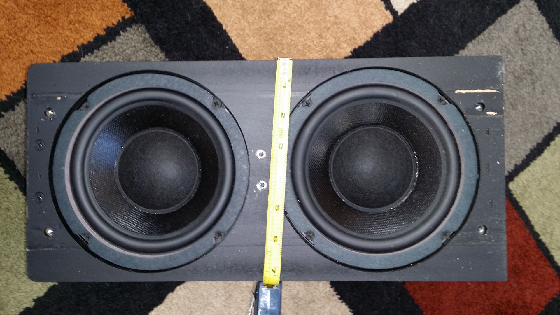

With that said, being DIY in my ways, I've instantly taken them apart to see what the base drivers are like. I didn't recognize the brand so instantly I knew they can be upgraded! So here is what they are like inside:
My initial impulse was to drop two Scan Speak Illuminator 7"s in there instead of the OEM woofers, but there really isn't enough room in there. The cutouts are for two:
165mm OD
150mm ID
100mm depth

I can't speak enough about how wonderful the neo magnets work in a small box, especially in a box this small, with a neo magnet so huge.
The most improvement is in the motor force and the lower Q and lower resonant frequency achieved with such a beefy neo motor. The OEM drivers, while they did use a huge ceramic motor, they were still undermotored for the job. They sounded boomy and the resonance was clearly audible. With the Satori I get a seamless transition to the low distortion Martin Logan push pull subs. It is however true that overall output is largely the same. So I kept a high xover but now it simply sounds like it has better extension and transparent.
The other sweet bit is the suspension. With the one of a kind spider this driver has the speaker achieves the same centering needed in the gap with twice the softness of a high end driver. The time domain resonse is outstanding compared to the stock units. Part of me also believes this suspension is as good as it gets rattle wise without push-pull. You get high excursion without a ton of motor force exerted on the cabinet, so less transmission of vibration to the floor board. A proper match to the planars and the sub I have.
