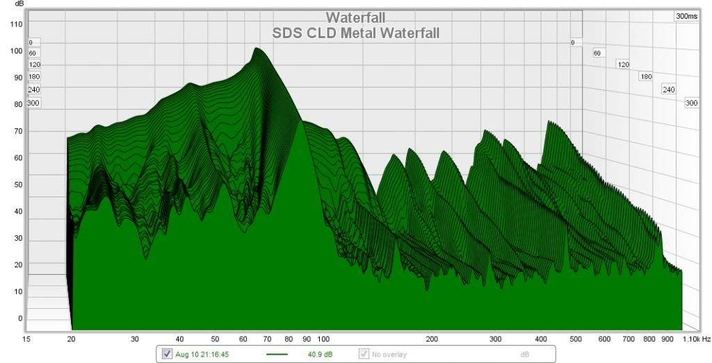

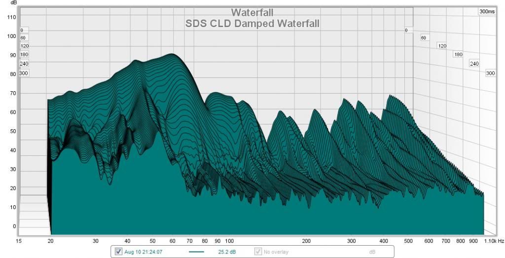

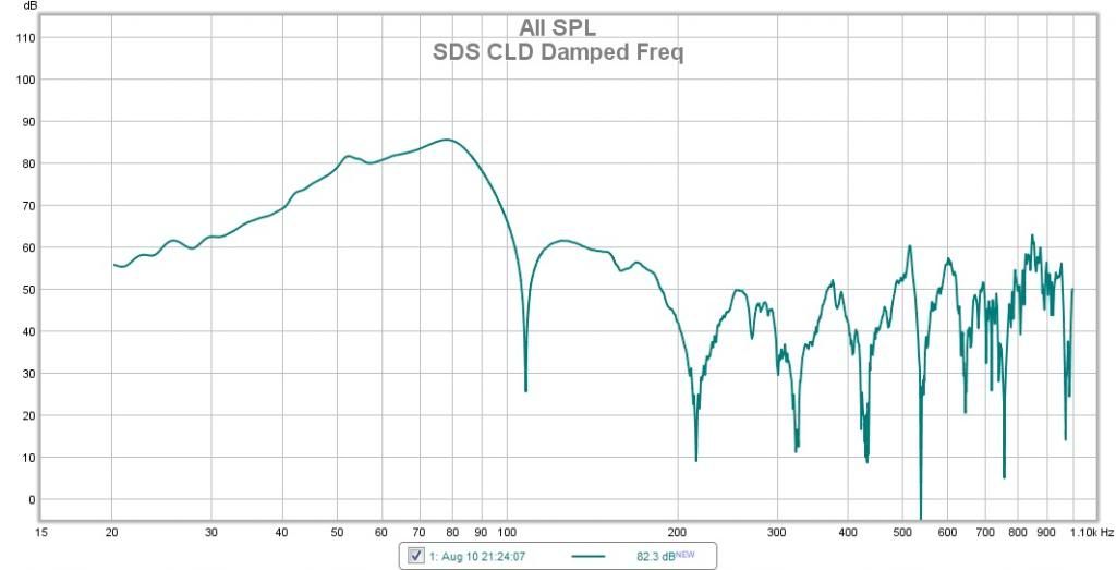

Definitely not reading this right. SDS performs significantly better than Knu and stinger.
Stinger has an 8db drop in amplitude on the main resonant frequency.
Alphadamp has about an 11db drop in amplitude on the main resonant frequency.
Knu Resonance Controld has about an 8db drop in amplitude on the main resonant freqency.
SDS has about a 14db drop in amplitude on the main resonant frequency.
Furthermore, pay very good attention to the waterfall plots. You want the damper to roll off vibration as fast as possible. SDS and STP Bomb do this the best so far. Both do much better than Knu or Stinger (or alphadamp).
