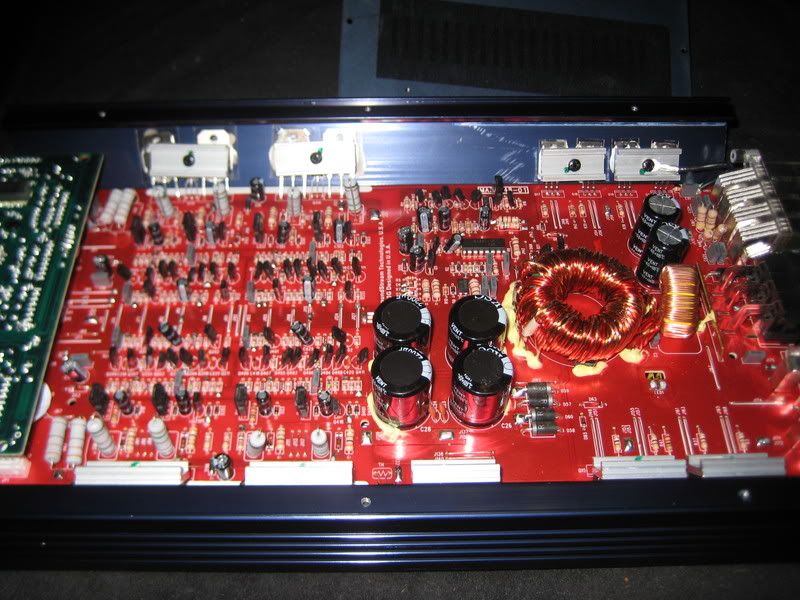

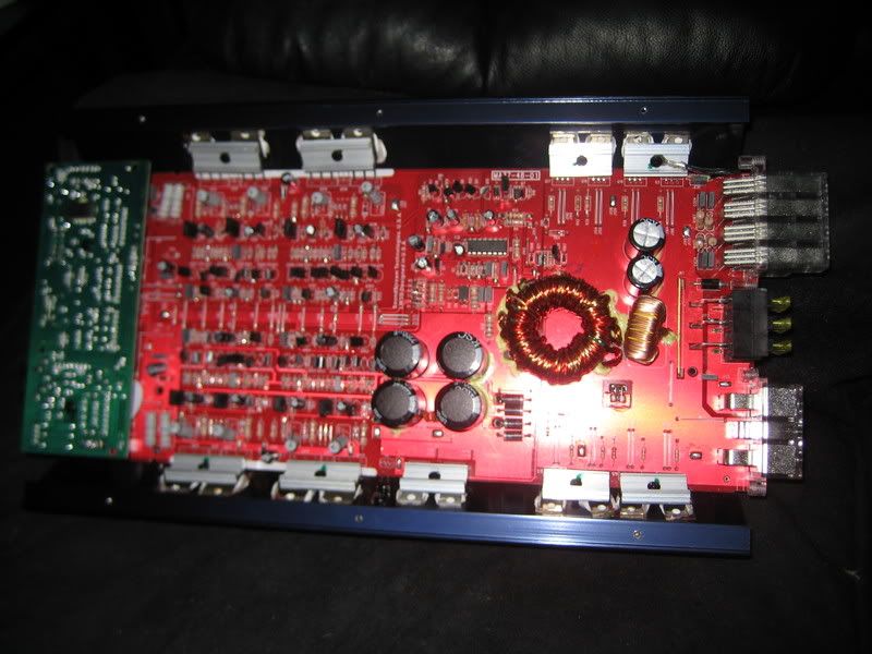

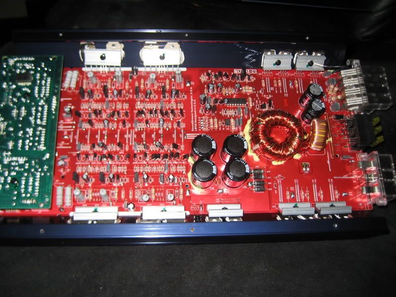

OK, so I got the Rub4.600 in today. Opened her up and took some pics. Now before this goes the way I think it will, remember this is a $200 dollar amp so please keep that in mind when trying to compare it.
So what I was told is that this is the lil wonder for the states. Europes are called little wonder and they have been out for alittle over there and have been well recieived.

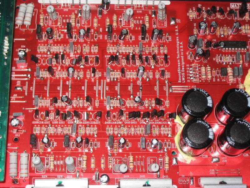

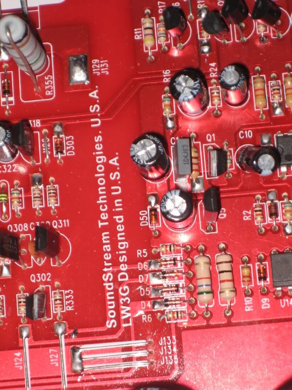

looking at the board you see that it is labeled LW3G, and it states it was designed in America. These amps are coming out of China and not Korea

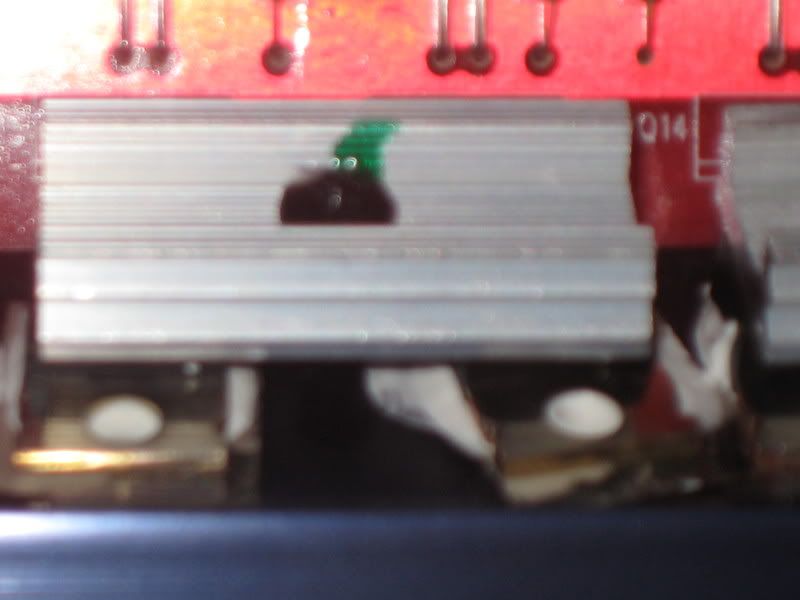

I was touching the connections on the board just to see if they were secure, they all were but you can notice this is alittle crooked but the connection is fine.

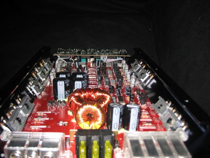

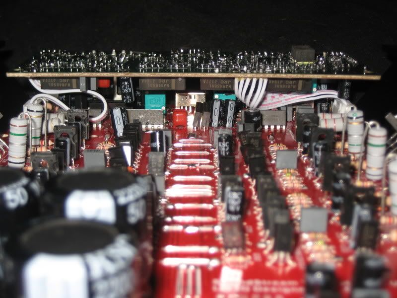

Not as nice as the old stuff but for the price it might not be bad at all. I wasnt expecting dual power supplies or anything in an amp this price. So here are the rest of the pics I took.

That thing looks like a power acoustik board; some crooked stuff and no SMD, soldered jumpers. On the other hand some old school amps look nasty inside too, it really depends on the design and components used. Is very hard to tell by looking, at least for me. The new alpines made in China some have four layer boards like a PC and lots of SMD, but hard to repair. They are made mostly by machine. IMO how fast they break is about the most important factor.
Is it 4x150RMS@2ohms? A lot of 2x120rms at 4 ohm amps have the same number of transistors as that, but it depends on how good that parts are as to what they will take.

The manula says 100 x 4 at 4 ohms, I got it hooked up over the weekend, I think its alittle under powered which is what i was hoping wasnt the case, it puts out clean power as far as I can tell. i was hopping to get it benched but dont have all the gear I need to, to do it. I might send it off to the guys at Zed to get it benched if I have the time, or I might just sell it.
I moved my DLS nobelium 8.2 active with it and I am not getting the 8" to move as far as before or have as much output, considering it was runnign off an old school Kicker zr240 which is probably putting out 90-100rms per channel thru the passives.
All in all I think its a decent amp for the price. I will probably not end up using it as its not up to the standards I am used to with the expensive amps I usually run.

Sorry to hear that. The construction looks pretty cheap, but sometimes you can still get a good amp. Cosmetically it's beautiful. I'd buy a couple heat sinks and drop some nice boards in them.

I just bought a rack of resistors to test properly but not got it going yet. I've found that with other cheaper amps, they just rate them on fire. If you get one that is larger than you need (more or less) then they can work well. A lot of them sound good, though some freak out more when they go into distortion like my kicker does...and I was told kicker was middle of the road not junk amp. I don't like it whatever the case (for my use) but then again my favorite amps were likely more expensive. A better amp tends to be you can use all of its power where cheaper ones you can't. I do have a 2x200rms super cheap amp I'd like to try in my car though, but its huge. I bought it slightly used for <$40 tmd! I think it was rated 2000 peak and 1x500rms bridged. Where this SS here has 4x2 outputs/ch this has 2x6 output transistors. I find only the larger class AB have 2x6, also have a hifonics 600 zeus and an giant ultra linear like that. Given transistor qualities vary, that is only a very basic way to judge an amp's capabilities. In fact I have a SS 880 that is larger yet but I'd rather use class D for subs not sure that would work well for highs and again its huge. Really cheap amps can have other issues too like misbalanced channels and noise floors, etc., even brand new. Hard for me to test for that kind of stuff but have seen obvious examples. That said I have used lots of cheap stuff with success over the years, kind of fun IMO but a lot of trial and error and some things you just can't like say an external xover or EQ, or likely a HU. Most of those put noise in and you lose out. If I have enough 12v power I've just kept some of these amps around to test when get the time.
