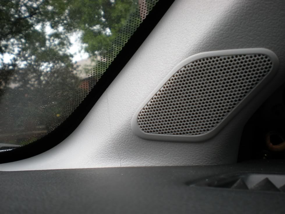

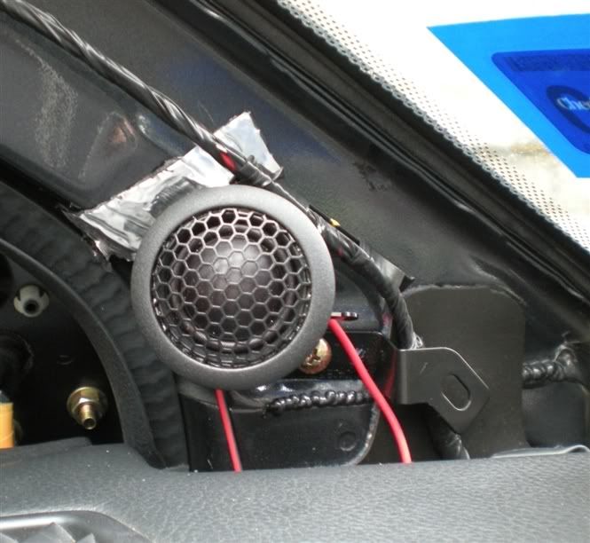

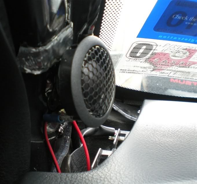

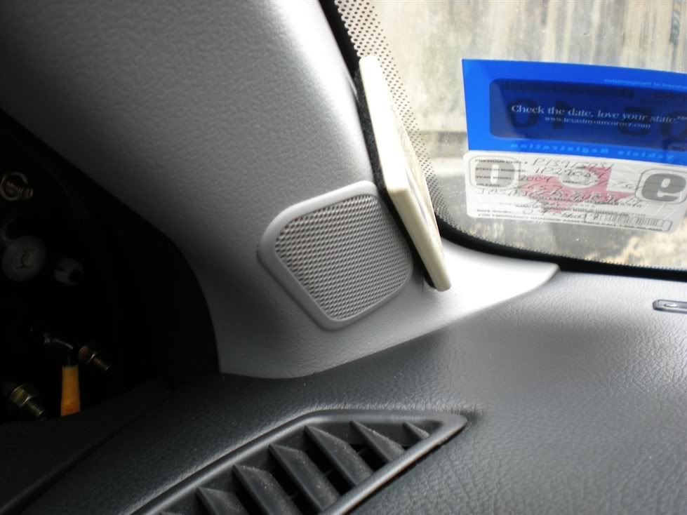

I listen mostly to rock and metal, so I wanted a mid that could really pound out the midbass. Typically drivers that can do this tend to give up some upper midrange, so I needed a tweeter that could be crossed low. I didn't want to have to fiberglass pods for large format home tweeters. I considered the Image Dynamics NX30 and XS28, but I finally decided on the Seas Neo textile dome (Prestige 27TFFNC/G) from Madisound for their great price, low Fs, and the fact that everyone here loves them. I'm planning on high-passing them at 2.5KHz with a 12 or 18dB slope.
They're screwed on to the stock tweeter bracket via a hole that Ryan drill pressed in for mounting purposes. They just barely fit behind my A-pillars. They're aimed just behind the dome light.

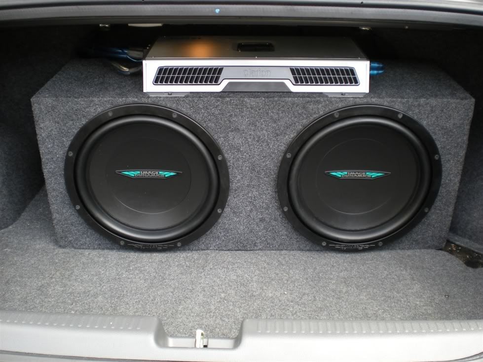

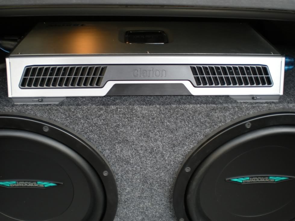

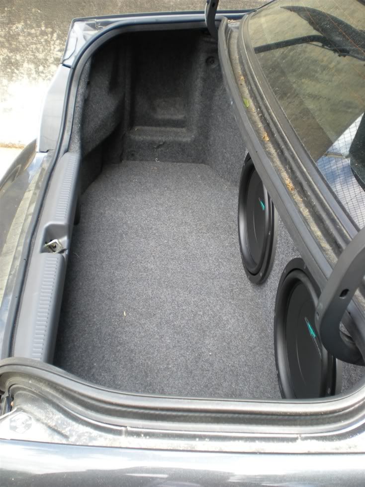

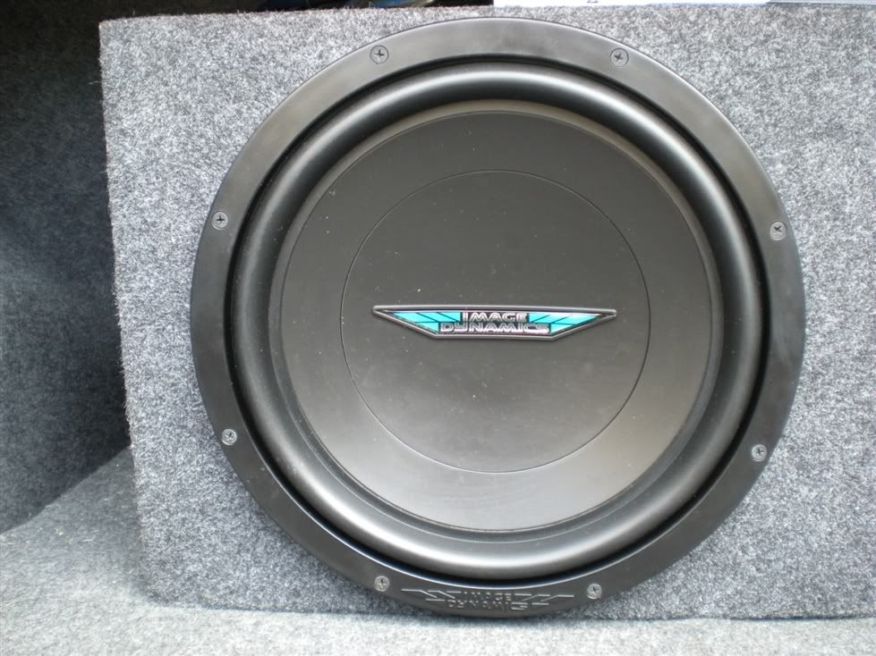

I also wanted a pair of subs with really good transient response for the type of music I listen to. I scored a pair of brand new Image Dynamics IDQ12v3's from dman for a great price. They're installed in the ID recommended enclosure of 1 cubic foot per sub. No polyfill as of now, may add some later. Just a standard sealed enclosure made of 3/4" MDF. I just wish the terminals were on the back rather than on the sides.
I haven't decided what I'm going to do for a grill yet, but I'll figure something out because the rifle cases have to fit back there for range days. Also, I can already tell I'm going to need more sound deadening in my trunk. I feel like these suckers could easily shake my car apart if I let them.
The box for the IDQ's says 450W RMS, the manual says 500W, and somewhere on the ID site (or maybe it was woofersetc, I don't remember) it says 750W RMS. So I figured I'd get an amplifier that has plenty of power for when I want/need it. I decided on the Clarion DPX 11551 class G/H amp and picked up a brand new one from KnightWhoSaysNI. Runnin' this bad boy at 2 ohms for around 1500W, not that I'll ever really need that much :D

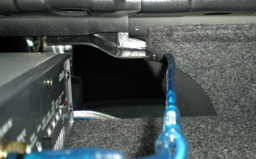

The factory Infinity sub used to be on the passenger side in the trunk, where you see the small area that isn't carpeted. Not sure what I'm going to do about that yet, but I thought it was kinda lame that Mitsubishi didn't feel the need to carpet under it.

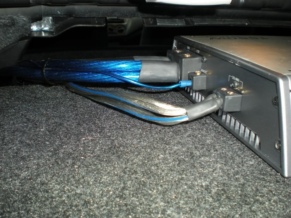

Since I know someone will ask, my previous mono amp took two 4ga power and ground wires instead of a single 1/0. That's why you see two power/ground leads coming from the amp. Overkill? Probably. But I have the wire already run and it saves me from buying a new distribution block and fuses. Works all the same :) Thanks again to Ryan for the heat-shrink tubing.
Also, I took out the speakers in the rear deck like most people do to let more bass through. After listening (albeit with only tweeters and subs) I think I'm going to seal off the holes, either with a speaker or MDF or Damplifier or something. I guess I just like the subs to be sealed off from the cabin.

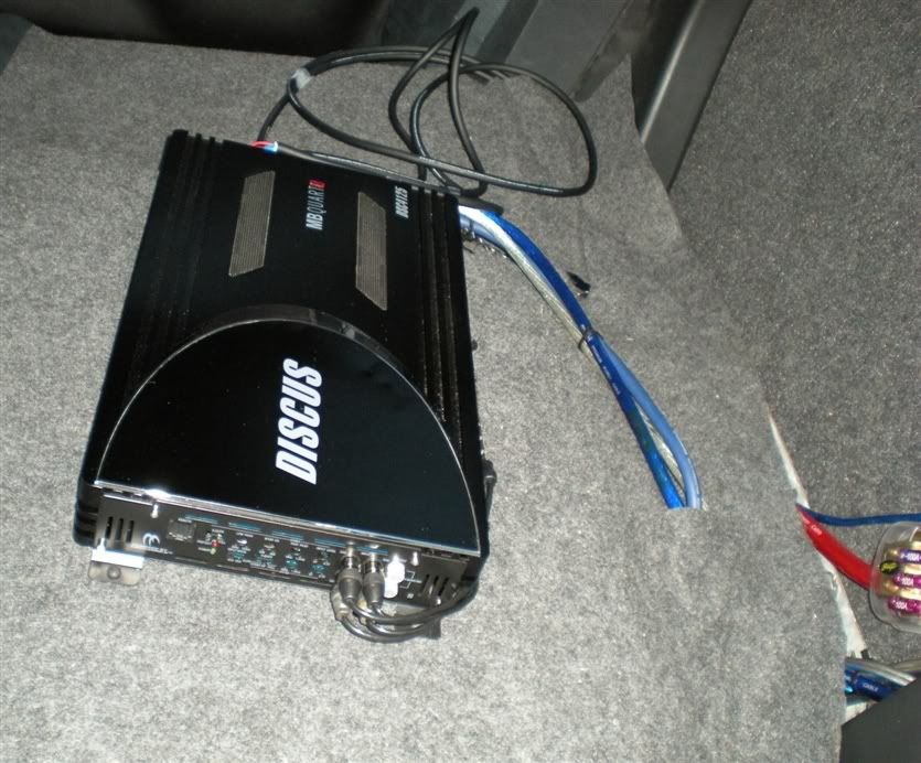

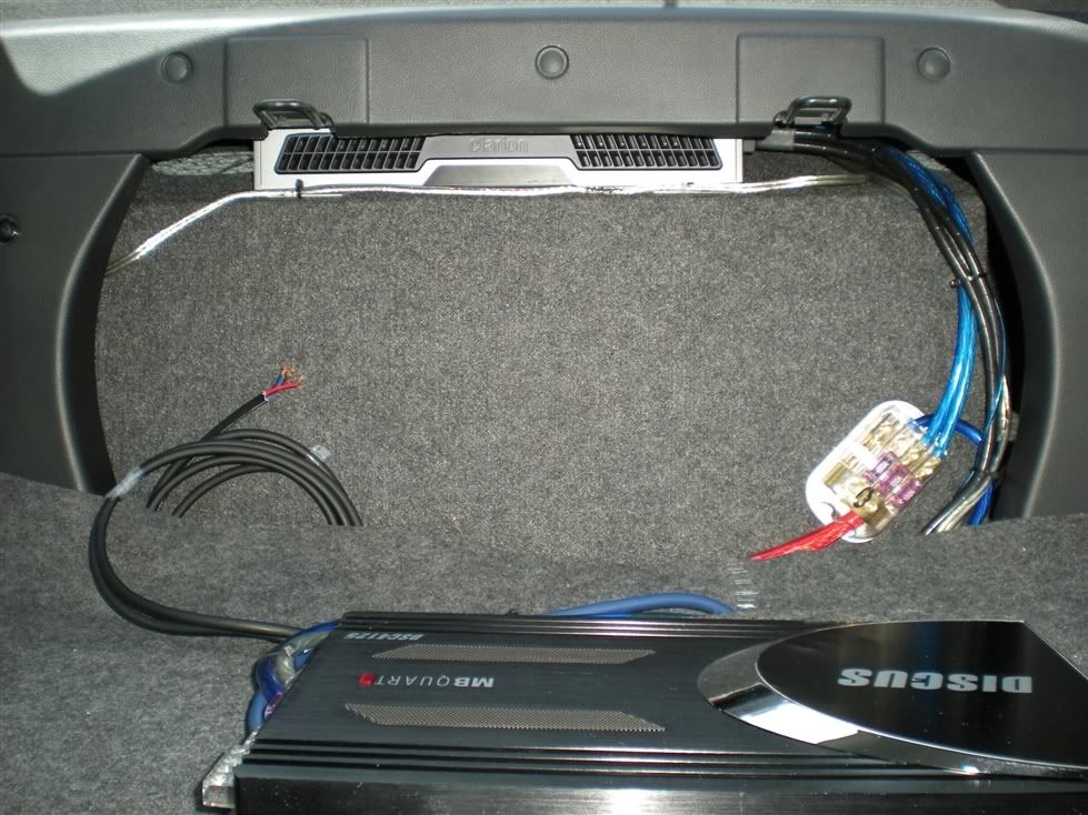

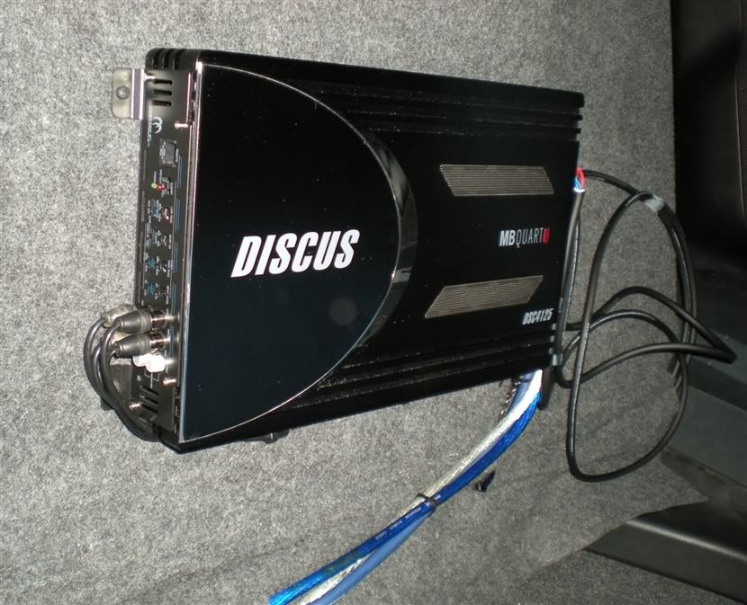

Powering the mids and tweeters is an MB Quart DSC4125. Powerful, solid amp. This is the other component that's staying from my previous install. It had a tiny bit of noise, but I'm hoping that with the 4V output of the Imprint processor vs the 2V output of my deck, it will be cleared up. The amp is mounted on the back of the fold down rear seat.
I did some more work organizing the wires after I took these pics, so it looks a little better now.
Once I get the new mids in, the Monster 4-conductor wires will be cut to the proper length. There's an old 9-con wire there too which used to carry the power for the Alpine front and rear speakers, but that has been replaced with the thicker gauge Monster cable. The only reason it's still there is for the remote turn on lead. I didn't feel like ripping it out simply to run a single remote wire, so it's probably going to stay for the forseeable future. Both sets of wires were run by shops. I was kinda pissed - when Car Toys installed the 4 channel, they dented the decorative top plate. I might just take that off later.

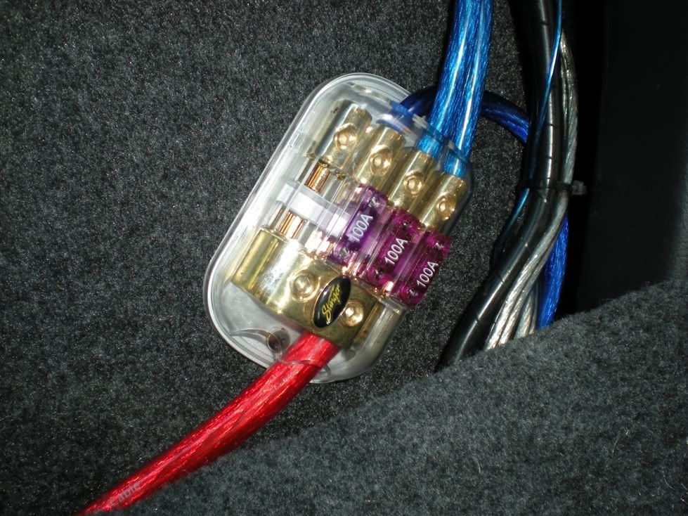

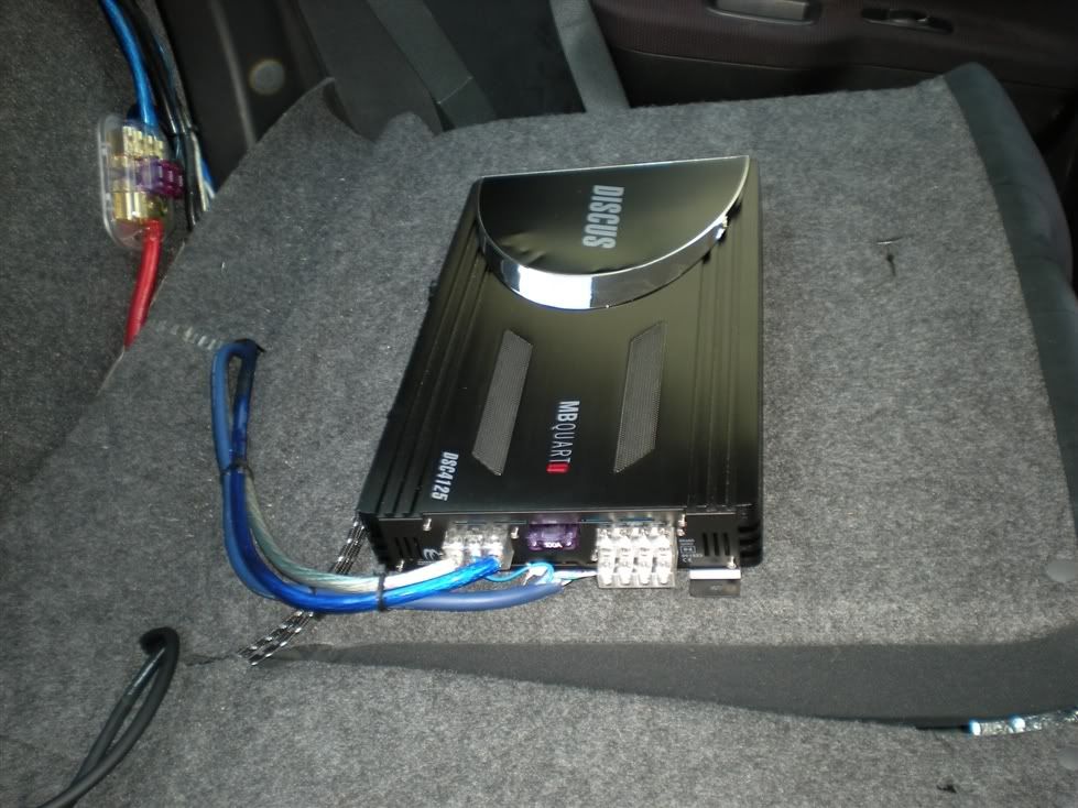

Here's a couple quick pics of the better wiring.
I ran the mono amp RCA's behind a trim panel instead of alongside the amp with the speaker wire.
Added a couple more zip ties here and there so everything is tight and secure around the distribution block.
Don't mind the staples in the carpet flap thing, that will be replaced with velcro. Just had to make sure that idea would work.
And here's how much trunk I have left.
