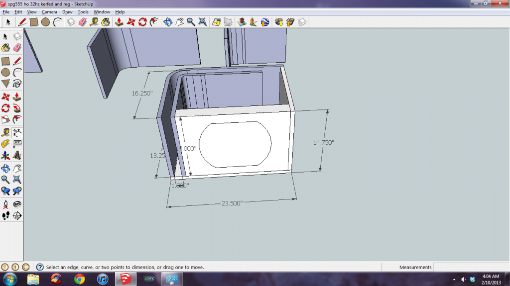

Sketched up the ported box. Start building this week. Car gets serviced tuesday then the ordering begins. More pics when I start tearing apart the car. box is tuned to 32hz and has nearly flat response should have excellent sq

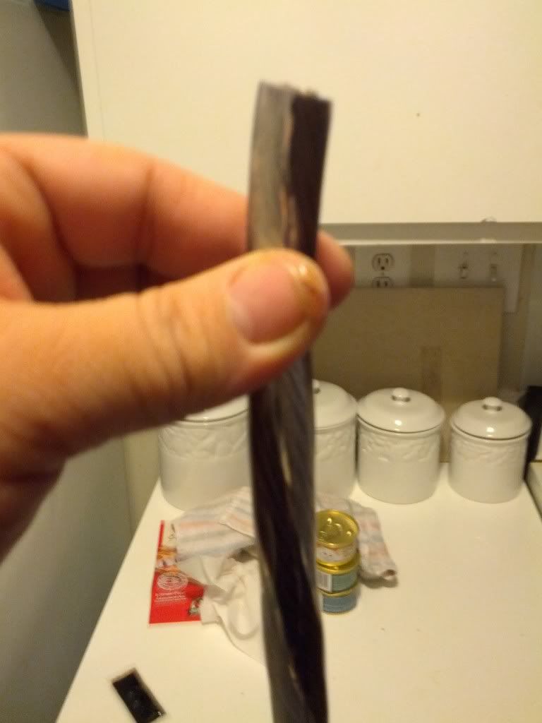

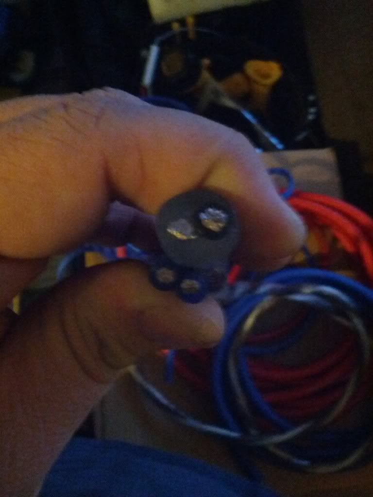

Here's pics of the speaker wire won't bore you with power wires lol

Also if you look at the 8ga speaker wire your like hey that's all PVC jacket not 8ga. No its actually 8ga ofc speaker wire twisted and then coated to form a single strand (think of higher end RCA's). Its about as thick as my 1/0

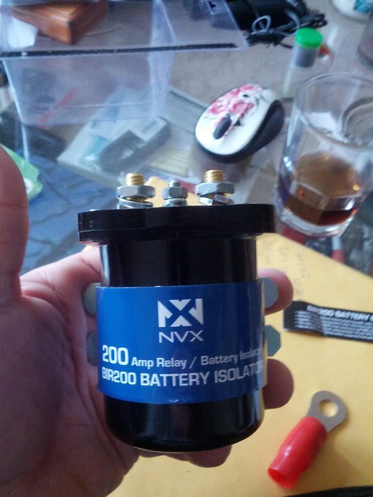

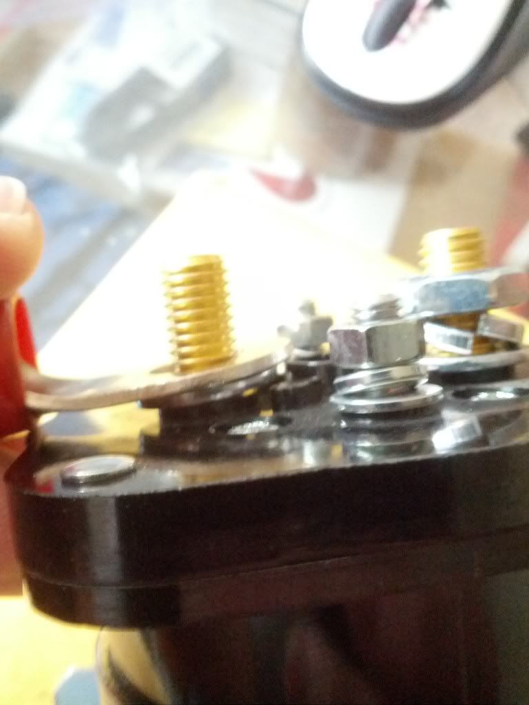

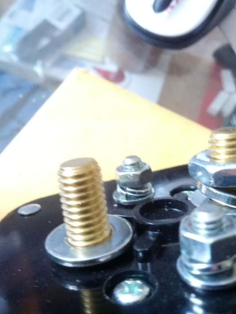

Received the battery isolator today. Nvx 200 amp cont. 300 amp surge. Way overkill but heh isn't everything I do lol. You can see by the pics I'll have to get two more washers to put on the power posts in order for the 1/0 ring terminals to work. No biggie. The rest of the stuff should be in tomorrow. Box will be started next week (funeral, and birthday this coming weekend). I'll post new pics of the box. I had to redesign after finding excessive port velocity (noise) in both of my modeling software. Made it about 4 inches wider and doubled the port width.
Pics of the battery isolator:
