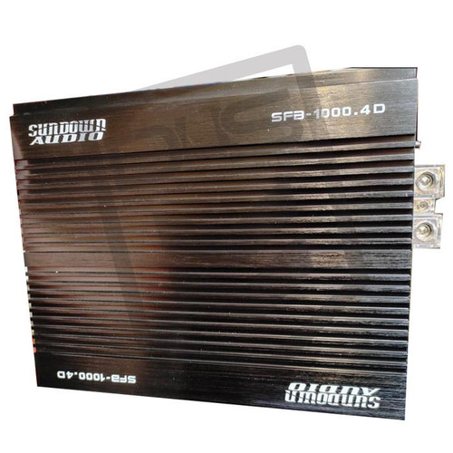

I have a BNIB SUNDOWN AUDIO SFB-1000.4D ( 4 Ch Full Range Amplifier) $375 shipped. Why not use a good 4 channel andbridge a set? Affords one flexibility down the line should the need changes.
4 x 350 at 4 ohms or 2 x 350 and 1 x 2000 at 2 ohms bridged, 2x 590 x 1 at 2000 bridged at 2 ohms.
Pretty crazy amplifier. Purchased it then realized that It won't fit, by a hair. Going to cost me $100 restocking fee, figure someone can benefit from my goof instead of shipping it back.

The Sundown SFB100.4D is an exception. 4@1ohm, OR 2@ 1, 2 or 4 ohm and 1 channel 2 or 4 ohms bridged. Rediulouse power output.
