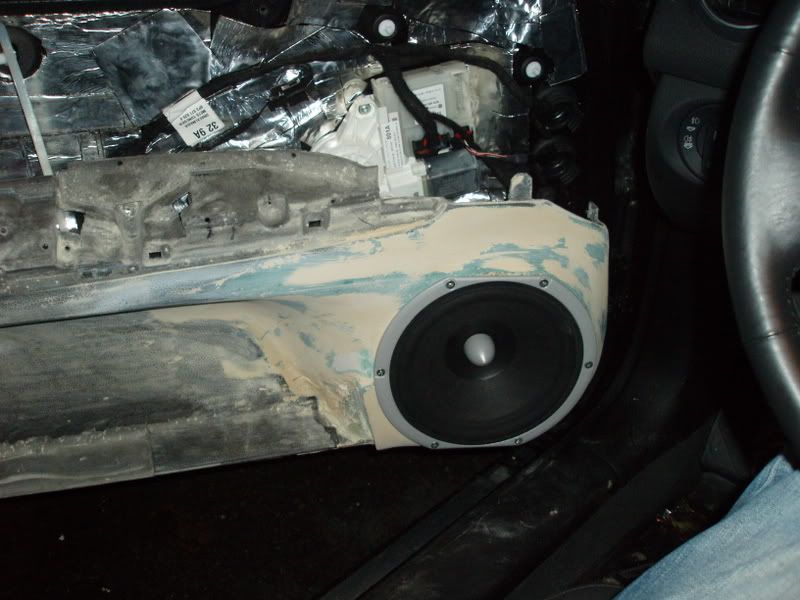

I need to make some grills for my door pod and kick mounted drivers. Any pointers?

it sounds like your pods and panels are already built. This changes construction methods entirely and greatly limits your options.
if your drivers are surface mounted, I would use the two piece grilles as already mentioned. I too have experienced problems with these grilles rattling. They are also prone to denting from sticky fingers. But here is a trick to help you with that:
nab a bottle of contact cement and some grille cloth and upholster the grille. if you only apply the contact cement to the outer ring, then any dents made by dumb friends will be invisible. Furthermore, sinc eyou will contact cement the outer ring on the outside and inside, this means a layer of grille cloth will always seperate your two metal rings for your two piece grille. this should effectlive prevent any rattling short of metal mesh related rattles, which can be taken care of via silicone before the upholstery process.
..........now! if you have flushmounted drivers or even better if they are countersunk, youve got totally different options open, and especially combined with the use of a router you can make passable solutions for those drivers as well. do you have any non-photobucket pictures of yoru pods and kickpanels?

The problem is basically this: car door skin with hole. The hole is kind of a funky shape, and there isn't much room AROUND the hole (the hole goes about a half inch up to the edge of the door skin). Need a grill to go over it. I could cut a thin piece of MDF to basically trace the outside of the hole, cover it in vinyl or something so that it meshes with the door ok, and then affix the grill to the MDF piece. But it's not clear how to get the grill metal attached to the MDF and still look like one piece. You'd still see the edges of the grill metal over the MDF, and that stuff is too strong to be able to bend it all around to hold its shape.
