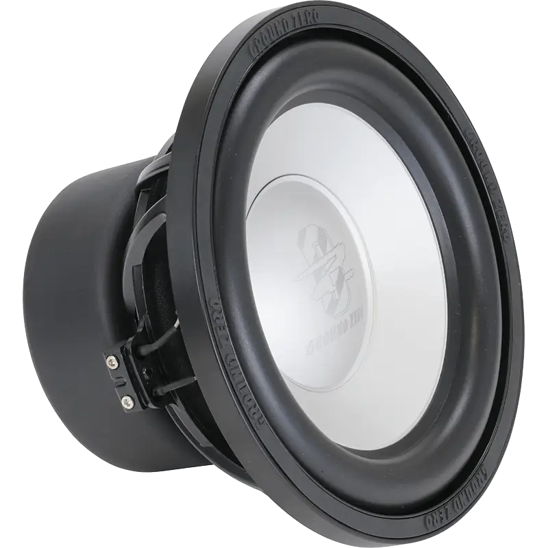

That's a Ground Zero sub.
Older version of this?
#11 ·
Just saw the info on that post - one needs to read between the lines!
#12 ·
That’s not the same model. The frames and motor are different from current models. Also this was made in the USA. Eclipse TI pro looks to be the closest.
