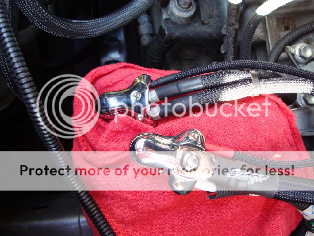

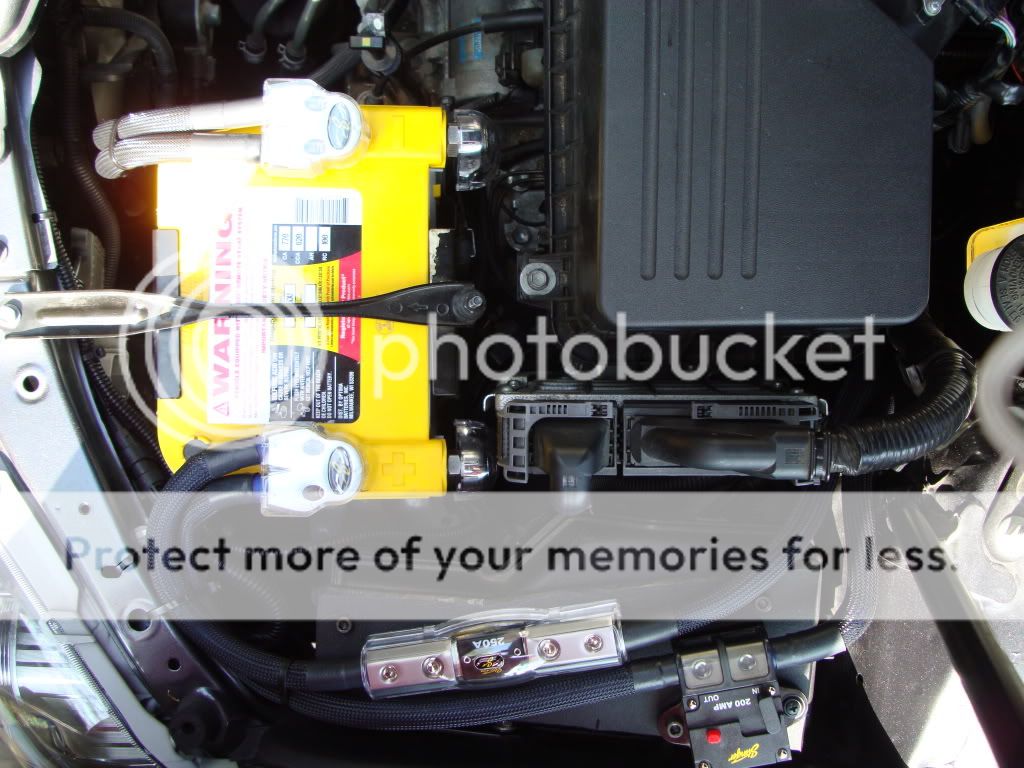

Onward, back to the engine bay to finish.. I ran the cable from Alt to battery.. There was not a real good spot to route.. Damn bracket holding the ECU needed some work..
Some cutting and grinding the edges work and space has been created.. Probably don't need the cable route holder on left, but what the hell..
Power cable to rear of car, small space in wire wrap for grommet in firewall to tighten down on..
Alright.. the "Big 6" is done.. I'll be putting up some more pics shortly.. Also, after paging thru the electrical diagrams from Toyota, the FACTORY charging wire to battery is pathetic. 12AWG? seriously? I'll show a picture soon..

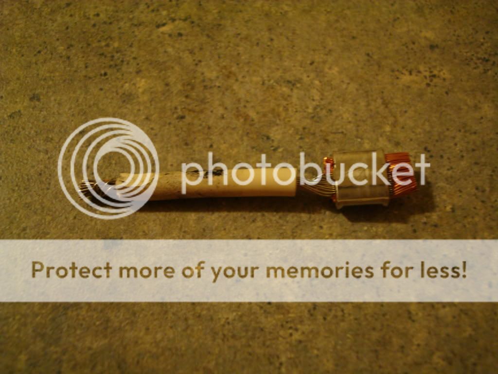

A Toyota WTF moment..
So, I was going thru the factory wires and ABOUT to tin the lead on the factory joke of a charge wire to the battery (it is in FACT 12awg, see picture next to 1/0)
So, I figured I would take up some slack and cut it down a bit.
Now THIS is the part that makes me wonder.. after removing the factory fabric wrap, excess electrical tape, I come upon this heavily heat shrinked area, so I cut the HS off and I was dumb founded. It is ACTUALLY a 5-6awg cable crimped down to a 12awg (about 6 inches long) and to the battery..
This concludes my Toyota WTF moment..

I believe that 12-ga section has the fusible link in it. That's why it is so small. On a side not it's really amazing how much your Camry engine bay looks like my Scion xB engine bay, down to where everything is mounted and run.

I did check that 12awg wire, unless the fuse is buried in the wire, it was just a straight wire. I know in the engine bay JB that the wire to battery is fused at 75 amps.
Does not really matter anyways as I now have the Alt to battery on 1/0..

indeed unusual step down on the charge wire, but also at that length and constant load 12wga might be technically enough to do the job for an OEM set up. (?)

Fusible link.. Yep. I picked up a 12ga FL wire the other day, but not sure I want to put it back into the loop. I know it serves as a safety precaution, but something REALLY BAD has to go wrong in order for this to melt.. Might just throw it in so I don't catch crap from the dealer if an issue ever arises..
Alright, the "Big 6" is done.. Every factory and Big 3 cable in place.. (You can see the cable where I cut out the FL) Side posts for factory, top for Big 3. Clean engine bay.. Might alter the starboard mount just a tad for additional clearance for the 1/0 cables..
I am also going to fab a new battery hold down with some 7075 aluminum.. This one does not work for me..

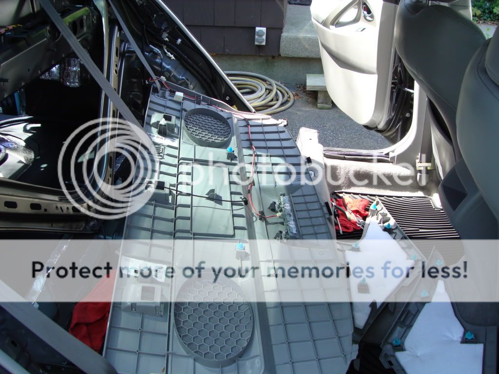

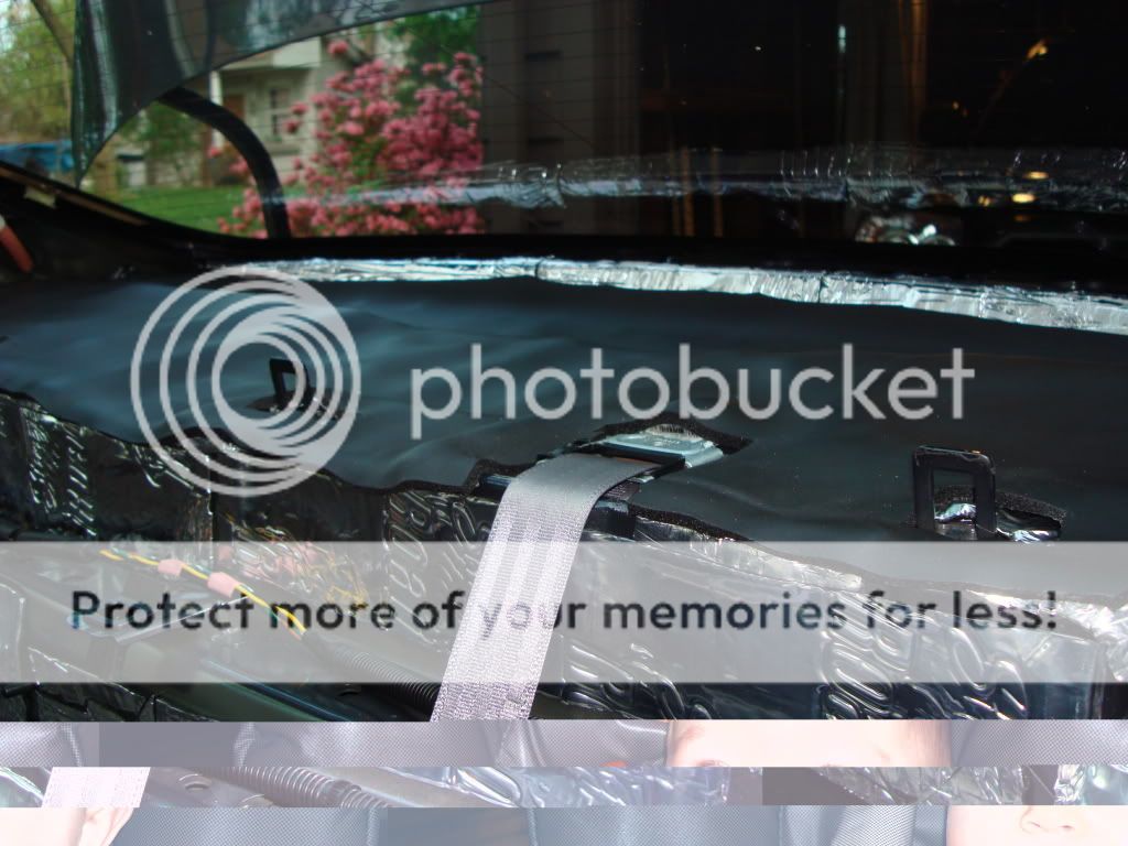

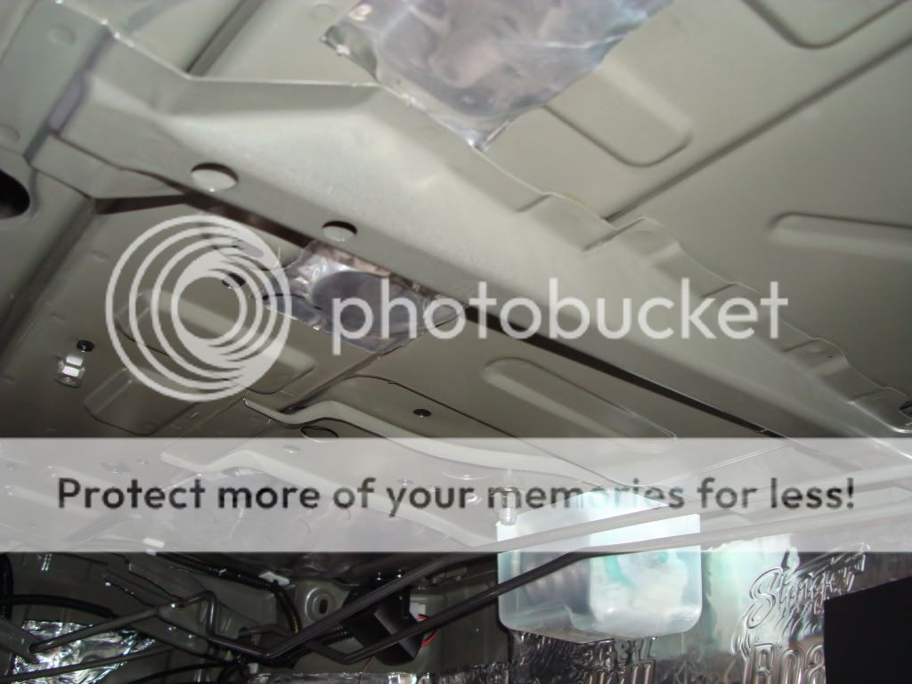

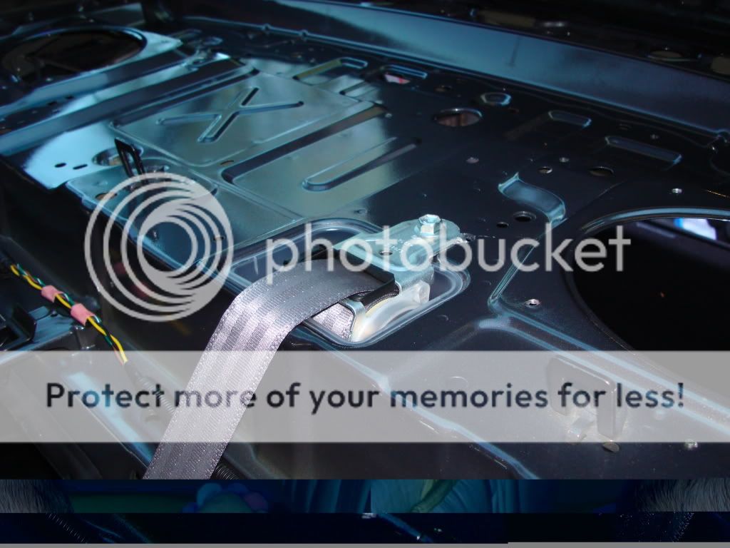

Ok.. To the rear deck and rip out the JBL speakers..
Cover up the large holes with Dynaplate (This stiff is like adding a steel panel in the car when applying to the back of a sheet of roadkill and adding a second layer. Solid.
Some CCF for the top, glued down by weldwood and done! Back to stock look.. I also ripped out the trunk light (absolutely useless) and I have the wires laying there. I am going to throw in a 4ft led strip to replace..

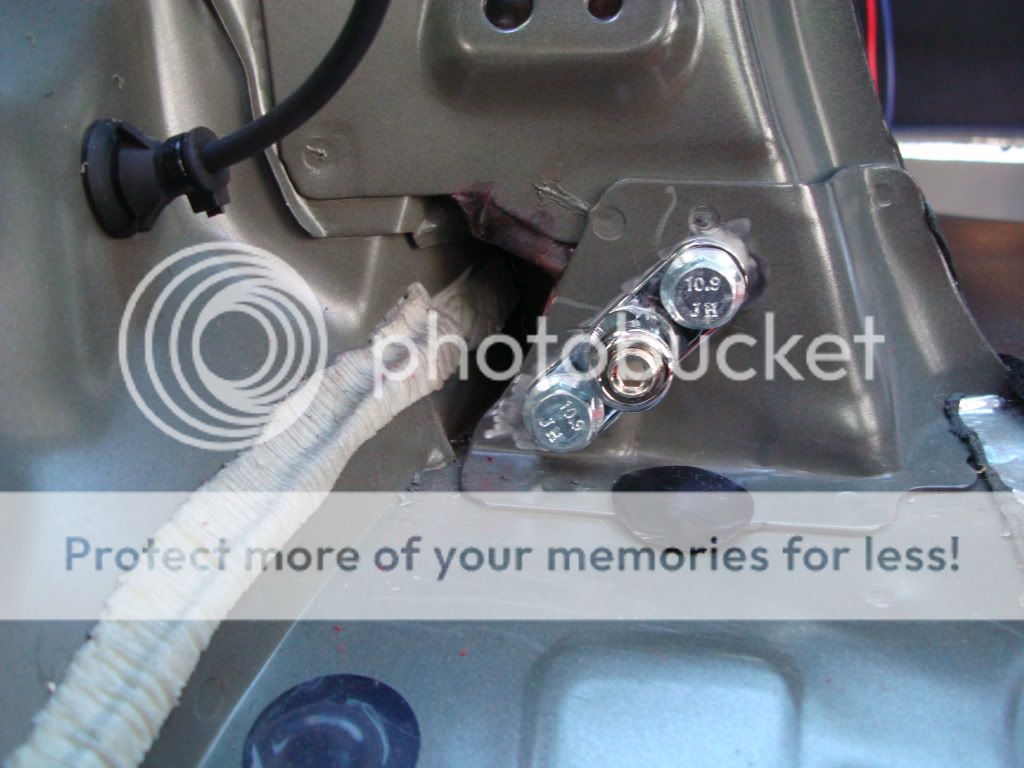

Trunk wiring for power completed. Following up with speaker wire next (already tech flexed)
