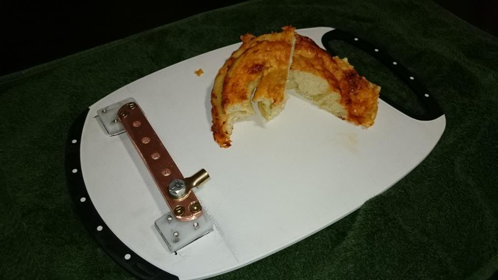

#37 ·
2 cutting boards, 3 dollars
A pizza bun, 70 cents
A power distribution block made from kitchen supplies, priceless.
Where are you getting cutting boards for $1.5/per part? I want access to that stash.
Your copper bar cost more than all that other stuff put together though, unless that is a scrap of copper pipe you had laying around.
