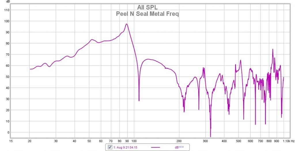

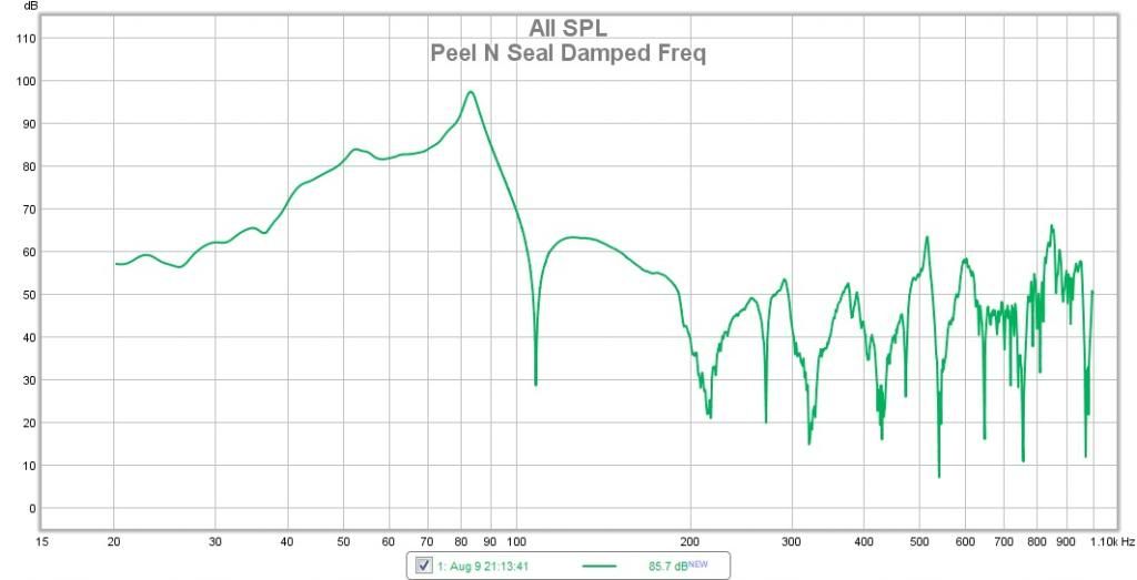

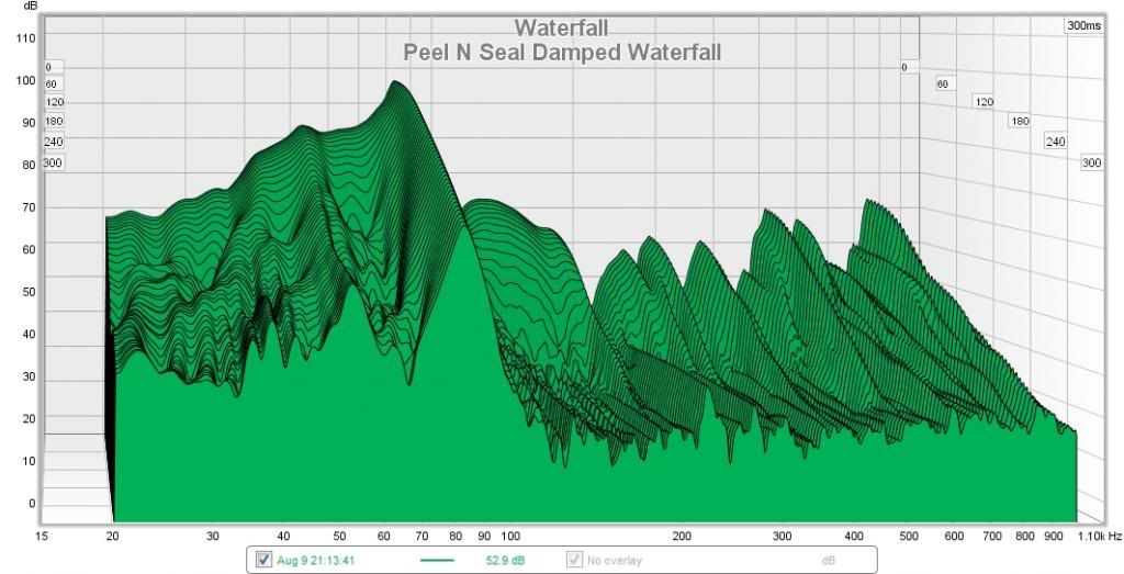

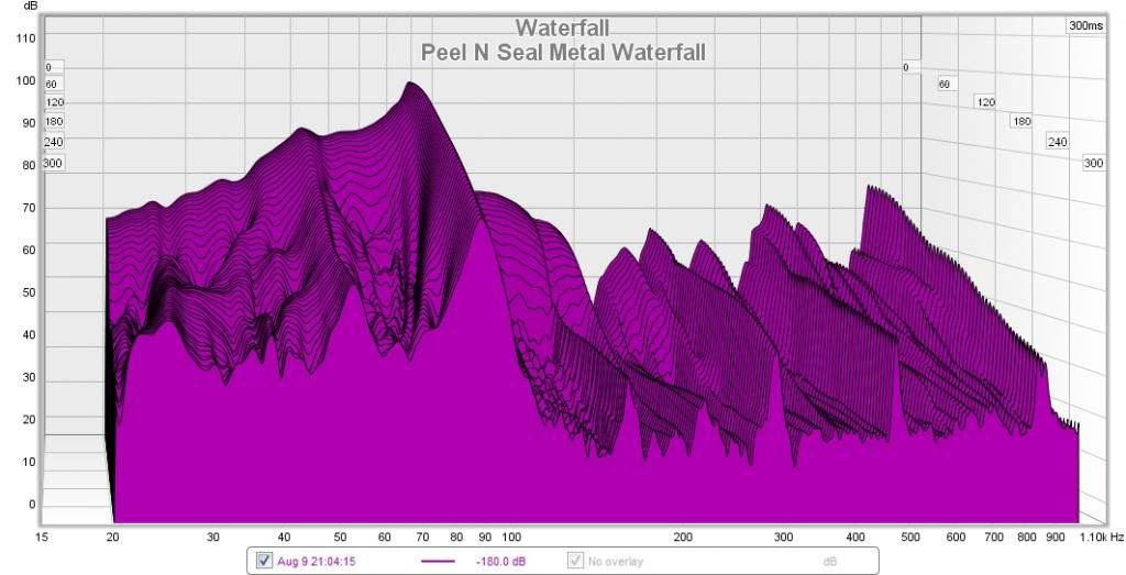

Peel N Seal
ACTUAL MEASUREMENTS
Total thickness - 40mil
Constraining layer thickness - 2mil
0.25 lbs per square foot
Notes - Very very similar to GTMat, just thinner. Same plastic lining between the asphalt/butyl and aluminum. Smells the same. This is so far, the most ridiculously difficult product to removed. (that doesn't mean it will hold up to the heat or time, just that immediately after applying, its the most difficult) I tested this product three times, moving the mic each time. I'm sure some people will cry foul, so I will likely measure again with the whole thing recorded on video.
Bare Metal Frequency Response
Damped Metal Frequency Response
Overlay of Undamped Metal vs Damped Metal Frequency Response
Bare Metal Waterfall
Damped Metal Waterfall
Again, pay more attention to the waterfall plots. Peel n Seal does seem to damp vibrations, just not at the main resonant frequency, and only at higher frequencies.

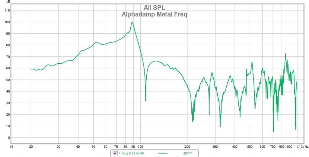

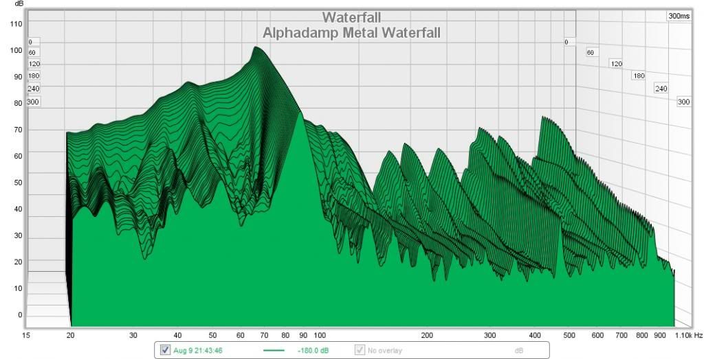

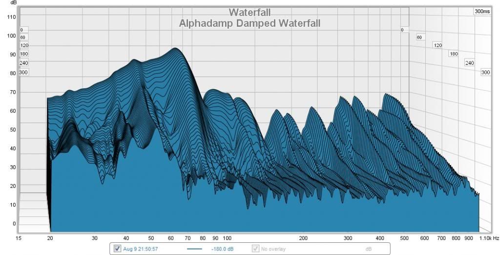

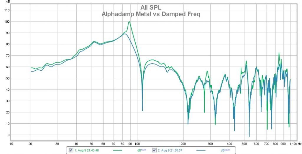

Alphadamp
ACTUAL MEASUREMENTS
Total thickness - 60mil
Constraining layer thickness - 10mil
.55 lbs per square foot
Notes - Feels very stiff. I've been told they use a higher grade tempered aluminum, and just comparing the aluminum layers, it seems like it. Constraining layer measured between 10-11mil, most spots at 10mil. I tested this one more than once as well.
These two are very interesting, indeed. I look forward to the continued test results.

Whats interesting to me is the one that performs the best so far, was the easiest to remove, and was also an asphalt product. And the one that performs the worst, was the most difficult to remove, and also an asphalt product. I should get three more tests done today, SDS, Kolossus, and Stinger.

STP Bomb is a special case. I would expect it to block sound better than any other product, as it is denser per square foot than anything else. All else being equal, density is the main factor in a cld's ability to BLOCK noise. That said, my tests are not capable of showing any reliable form of NRC, I purposely aimed at trying to remove that as much as possible from the results. CLD's should not be used as a sound blocker, as being coupled to the chassis, it just won't work as well as a decoupled barrier. It doesn't have to be mass loaded vinyl, it could be anything thin and dense. In fact, if your willing to work with it (and add the weight to your car), you could build a far better decoupled barrier out of raw sheet lead and closed cell foam than anything available on the market.

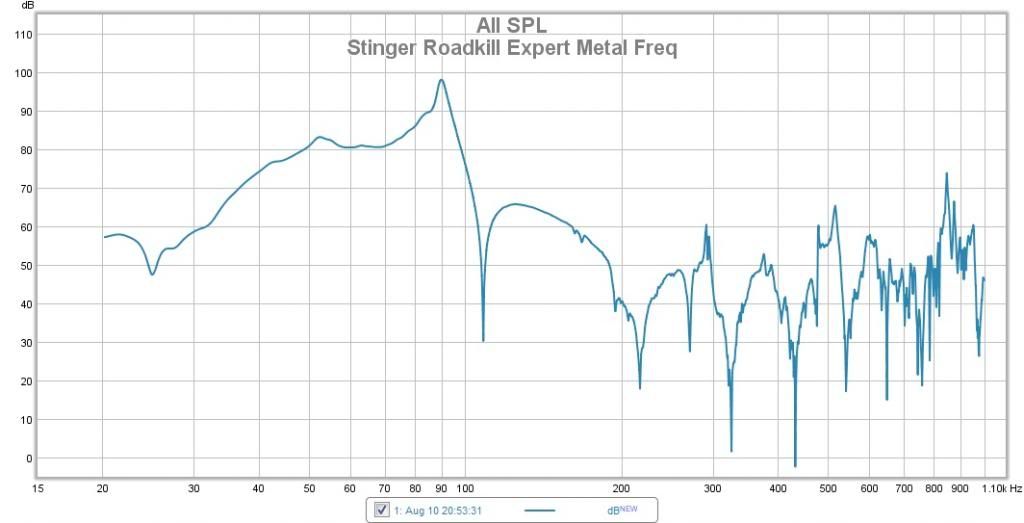

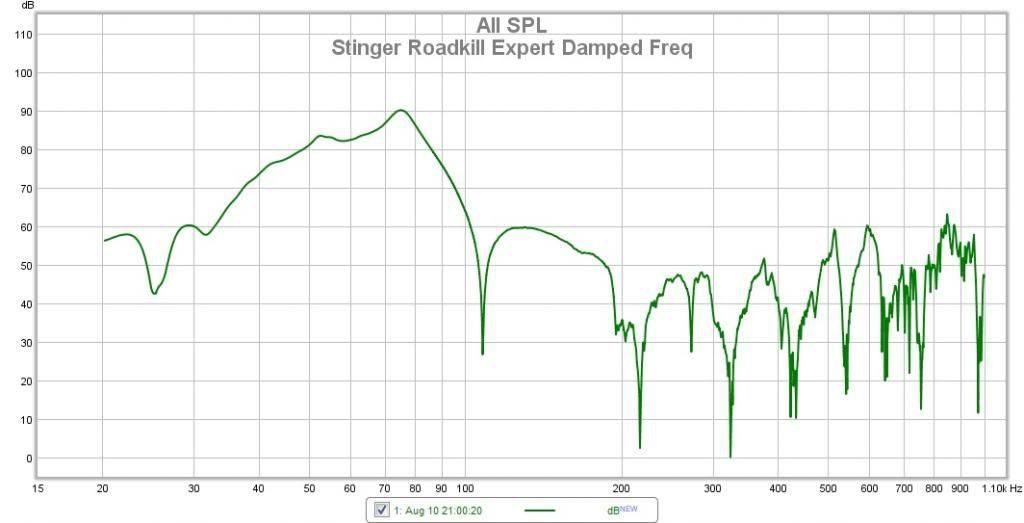

BFYTW, did you put the same % of coverage in both vehicles, in the same places? There could be hundreds of reasons that it doesn't seem to work as well. For instance, look at the Peel N Seal results. Listening by ear, the Peel N Seal didn't seem as bad as the test results actually are. But, that can be explained by looking at the higher frequency results. Peel N Seal does work on those higher frequency resonances, where the ear is more sensitive. That said, I tested Roadkill Expert last night, and it performs better (to the ear and the mic) than any asphalt product I've tested aside from STP Bomb.
Discussion starter · #260 ·
Stinger Roadkill Expert
ACTUAL MEASUREMENTS
Total Thickness - 80mil
Constraining Layer Thickness - 5mil
0.80 lbs per square foot
Notes - This product was off of published specs a little bit in constraining layer, and significantly in density. Published density is 0.65 lbs per square foot, but I measured 0.80 lbs per square foot. The butyl is extremely gooey, almost like chewing gum (also a butyl product). Constraining layer was 1mil short at 5mil vs 6mil as advertised.
Overlay of Bare Metal vs Damped Metal Frequency Response
